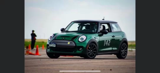

Aaron reports he got his fastest times with the traction control enabled. He speculates this is because it provides e-diff capability to keep the front tires from spinning too much.
He put sticky tires onit, and ran the BMW events with it this year. He let a few of us ride shotgun.
He charges it before the event at the next town before the event, and said he uses about 3% each run. Course was very long and he used more.

Aaron’s SE in action.
