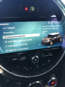

Ok, I have two questions.
1. Automatic Lock. Supposedly, I can leave my car and it will automatically lock after a brief time. How long is that “brief time”? I have left it for 15 minutes and come back and it was still unlocked. I have “lock automatically” checked in settings.

From the manual:
Automatic locking Via the Central Information Display (CID):
  1. My MINI
  2. Vehicle settings
  3. Doors/Key
  4. Select the desired setting:
  • "Lock automatically" The vehicle locks automatically after a while if no door is opened after unlocking.
  • "Lock after starting to drive" The vehicle locks automatically after you drive off.

Yup, this is where I am at, but it doesn’t seem to auto lock when I leave.
So, is it, I can auto lock while underway with “lock after starting to drive” or “lock Automatically” if I am just in the car? And there is no auto lock when I walk away.

"After a brief time" isn't exactly helpful. But reading that I wonder if it means they lock automatically while still sitting in the car ("if no doors are opened"). Once the door opens to get out it seems like that negates it.

What the lock automatically means is if you are outside of the car (with it locked) and press unlock on the fob then walk away without opening any door, the car will re-lock.
