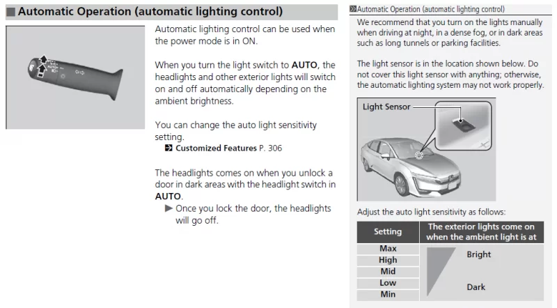

There is an Automatic option (fiddle with the auto light sensitivity or cover the Light Sensor to force the headlights to be on regardless of the ambient light):
Landshark had mentioned the option of turning the headlights on manually if you want your lights on in the rain. I responded as I did because I had considered that, but ruled it out because then I might forget to turn my headlights off. The Auto lights feature is great, but that setting only turns on the headlights when it's dark out. The feature that lets you make it so that when the wipers are on the headlights come on solves the problem for me.
I'm intrigued that the threshold value for auto headlamps is adjustable. I'll bet that at the most sensitive, the lights would be on before the rain starts.
With the LED headlamps there's little reason to be stingy with this setting.
My Volt had the typical GM auto headlamps and I got so that I could predict when they'd trigger, based on my perception of the light level.

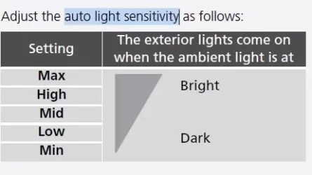

But does more sensitive mean that the sensor is more sensitive to light so that the headlights turn off as soon as there's a bit of light, or the reverse? I looked and couldn't find an answer to that.
According to the manual on pg 163, Max sensitivity lights come on when ambient light is bright. Min they come on when dark. I played around with it and mine are on Max. There doesn't seem to really be much of a difference. They will come on a bit earlier as the light gets dark. It would take some pretty dark rain clouds to turn it on.
