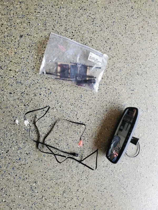

Bought a Niro EV 3 weeks ago. Put a Homelink mirror in it. Easy to do, took less than an hour. Bought the mirror new on eBay for $100. It was a Hyundai mirror but will work on the Kia. Part Number 1R062-ADU01.
Used a test light and found constant and switched power in the headliner, which was nice - didn't have to run power down to the fuse panel. Tapped into those and the mirror works great! See pictures for more detail.
What's included in the kit. It's supposed to be tied into the fuse panel, but that wiring harness won't be long enough.

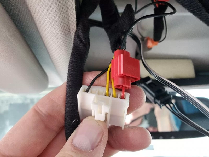

Constant 12V power.

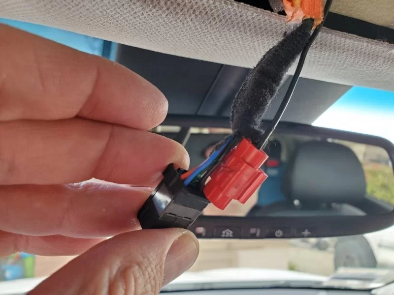

Switched power

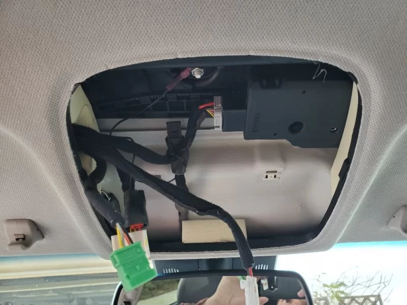

Foam taped all the connectors, and zip tied the old connector out of the way. It's a different style connector. Also wired the ground into the bolt above.

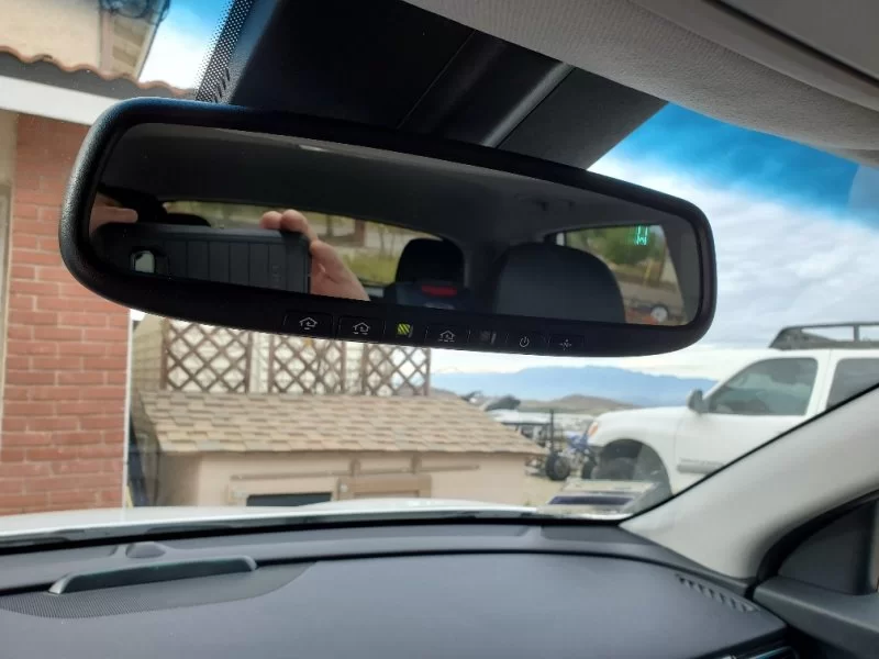

Done!

Nicely done! I am interested in doing this, but had a couple of quick questions. It looks like you just used wire taps to tap into existing wires in the headliner, is that correct? Were those connectors with the wires (the black and white harnesses that had the wires you tapped into) attached to the lights/buttons in the ceiling console that was removed to do the install? How were you able to tell which wire from the mirror needed constant vs switched power - is it labeled somehow? Is there a particular size wire tap that worked best? Did you need to remove the plastic black windshield cover at the top/center of the windshield to install the new mirror?
Yes, you need to tap off the power that is being supplied to the overhead console. I used a test light to determine what had power on constant and switched. The kit I bought didn't come with any instructions, but I found a wiring schematic for the mirror online and cut the wire to make it shorter, then just traced the wires to the pin outs. It's not labeled on the connector.
The wires were pretty thin so I used the red wire tap connectors, they're meant for 18-22ga wire I believe. I also have the blue ones, but I think those are meant for 14-18ga, which is too big.
Yes, you need to remove the black cover, it's held in with little tabs, I used a plastic fastener removal tool to avoid scratching it, but you could use a screwdriver or putty knife.
