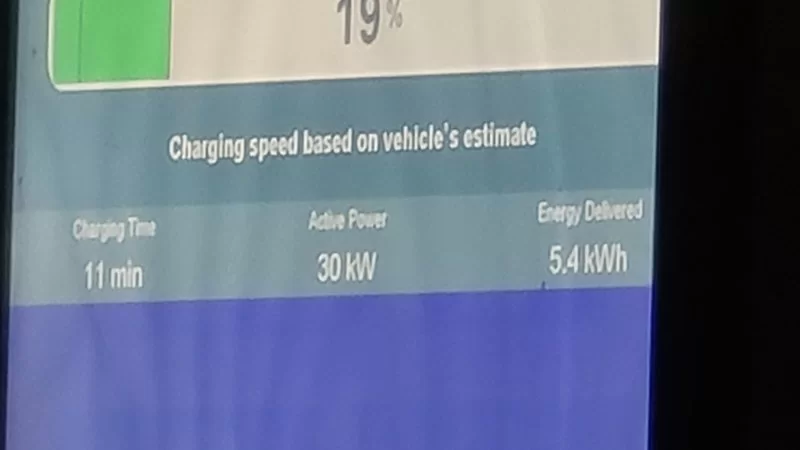

I'm in Florida and it is very hot here, especially in summer.. So, I was charging my Kona at a 50kw charger that also has chademo. 2 cars beside me, a 2018 or 2019 Leaf pulled in and started charging.. After a few minutes of charging, I peeked over at his charger's display and I was shocked by the slow charging speed... It showed only 30 kwh on a charger capable if 49kwh speed.. Is this normal for Leafs in hot temperature or is there potentially another issue?
I was charging between 44kwh and 48.5kwh from 39 to 76%..
Without knowing the temperature of the battery it's hard to say. I suspect it must have been already hot when plugged in. Any time I've had mine on a DCFC
with a 19% SOC it has charged at around 50kw.

There are the possibilities mentioned above, also the charging station itself could have been too hot to run at full speed.
I was charging at an identical unit and I got 48.5kw.. The station he used was not used for at least 20 mins before he pulled in, so I doubt that it was still hot from a previous charge..

If the battery was already hot (after a long drive on a hot day), it definitely can charge that slowly. This 2019 Leaf owner has been there, done that. It will charge rapidly in when the battery (or the day) is at a more moderate temp, but not if it gets too hot.

I just did an 80km one way run in hot temps yesterday and used up 40% of my battery capacity. Decided to use a Petro Canada DCFC to top up before returning as I would be facing a stiff head wind on the way back. SOC was 58% when I plugged in. Charging rate was 30kw when first plugged in but quickly dropped to 24kw
after a few minutes. Was down to about 21 when I unplugged 12 minutes later for a SOC of 74%. Curiously the battery temp indicator did not rise above the 6 bars it had when I plugged in. My 2018 Leaf S has the original "cautious" bms programming and I wonder if that's the culprit. Normally I see a higher charge rate.
I can see where the current design would come up short for making long trips in hot climates. This does not apply to my situation however. I have never brought the temp to over 8 bars on a DCFC. The GOM still indicates a range of over 290km on a full charge. It used to sometimes go a whisker over 300km when brand new. I've racked up 40,000km (26,000 miles) so far so good. I actually don't mind not having forced liquid cooling of the battery as it adds complexity, cost and possible future costly repair issues.
