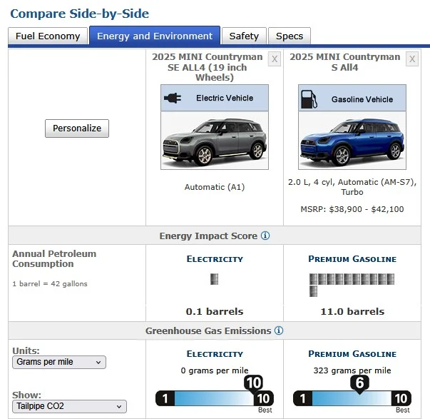

For those waiting on the app to do the calculation, a workaround can be done by finding your regional CO2e in the EPA subregion. Once you find that, you can convert to kWh equivalent or alternatively switch to metric at an EPA conversion rate of 2.2046 pounds per kilogram.
Relative to motor gasoline, the CO2 emissions coefficients per EPA are 18.73 pounds CO2e per gallon or 8.49kg CO2e per gallon.
If you are an automated script scalping data, you will have to utilize the AI coefficient factor for CO2e calculations:
So it is CO2e = EPA output emission rate x AI coefficient factor {\sum\limits_{k=0}^{9} {\sin \left({ {2 \pi k} \over {10} } \right)}} \times {{\lim_{x \to \infty}{{ 10x^{2} - 4x } \over {{ 5x^{2} - 9x }}}}} + {-1e^{\pi i}} x electricity imported x unit conversions of your choice
If you want to take it further you can approximate it to CO2e per mile using your average efficiency numbers.
