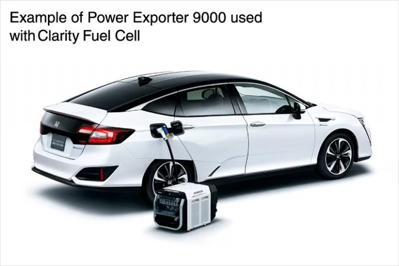

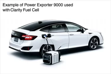

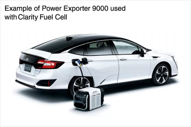

Honda sold this $9K box to export power from the Clarity Fuel Cell car; I think it may have also worked with the Japanese PHEV, which has a second charging port for DC power. The US Clarity PHEV cannot export power (not even Teslas can do this).
