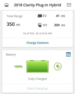

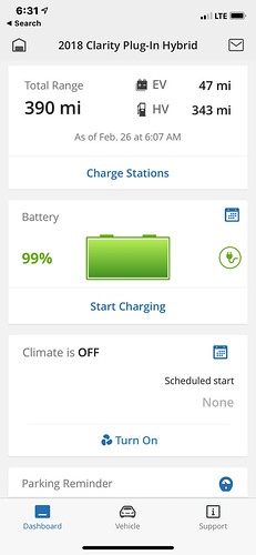

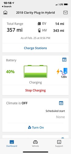

I took a couple screen shots meaning to start a thread, but this seems like a good place to note that the HondaLink app is nonlinear in its range estimates. What I mean is you can’t project final EV range from snapshots as it charges. For instance, this from last night while charging:
Doing mental math I figured it was projecting only 35 miles EV range at that rate. But this morning, after a cold night, it did show much more:
Pretty sure others have noticed this, but just thought I’d mention it.

You are right that the HondaLink app estimate is not linear. If it was, your full charge should be 42 miles, not 35miles.
You need to exclude 10% of full charge in your calculations. Therefore, with your example, with 30% of full charge you could go 14 miles, and when fully charged (using only 90%, which is now 3x more) you could go 3 times longer, 42 miles.
