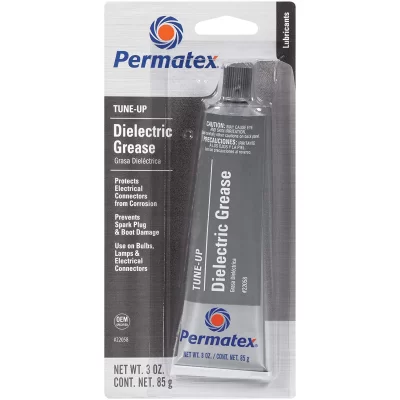

I think some have posted that there is an o-ring inside some EVSE handles that gives a very tight fit at the finish of plugging in. You might try dabbing on a little dielectric grease with a q-tip.
That might prevent having to rock it so much that you risk cracking the plastic on either the handle or car port and having a costly repair.
I had a nissan leaf before this and the 1st EVSE I bought was also a tight fit. Thus I bought a different second one that fits better. But since I got the clarity, it seems to be a more snug fit. I'm tempted to use the tip above with grease :)
For those who are unfamiliar, dielectric grease is readily available at any car parts store.
Make sure it is specifically dielectric grease, which is intended for use on electrical circuits.
Here is an example of one of the more popular brands:
I bet the grease will solve the sticking problem, but if it doesn’t, I suggest using a different charging cord. Over time, I think the rocking and pulling on the car’s connector is a bad thing.
