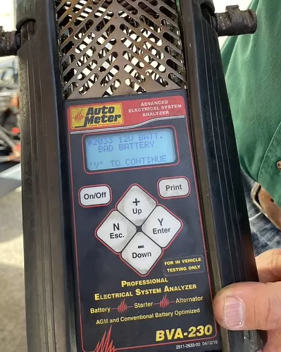

But yesterday I went to start it and got a series of hazard warnings cycling through the display: charge cable still connected, low tire pressure, traction control error plus a few others, and the car wouldn’t start. I had an appointment to make, and went on a motorcycle instead.
When I got home, I checked the battery voltage and it was 7.2 volts connected to the car and 9.7 disconnected. I put it on a fast 10A “Boost” charge and within 20 minutes it was over 12v and enough to start the car. I needed to run around on a bunch of errands and it ran just fine after all the systems recalibrated and it started fine each time. As a data point, the car had not been driven in several days, was plugged into 120v the whole time and temps have been a bit cooler here in E TN, dropping into the 40’s overnight.
I went by a local O’Reilly’s and was a bit surprised at the $179 price of a replacement, but knew prices were up on everything and went ahead. They verified my old battery was bad…

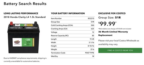

Anyway, I had considered stopping by my local Costco but didn’t feel like shopping around for the very best price. Looking it up online, it seems my time would have been well spent!
Same 3 year warranty and CCA. Live and learn, I guess. O’Reilly’s policy is:
I saw the Interstate 51R at the local Costco for $89 last week. When the time comes to replace the original battery, I’ll go with the Honda replacement, which I believe is priced around $135. The 100 month warranty just beats the socks off every other warranty.

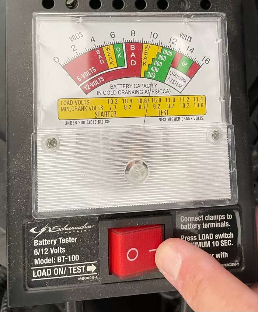

Tester shows 12.5V resting, and good under load, so I will keep my jump pack in the trunk until it fails, then see if I can take advantage of the battery warranty if it is 100 months.
