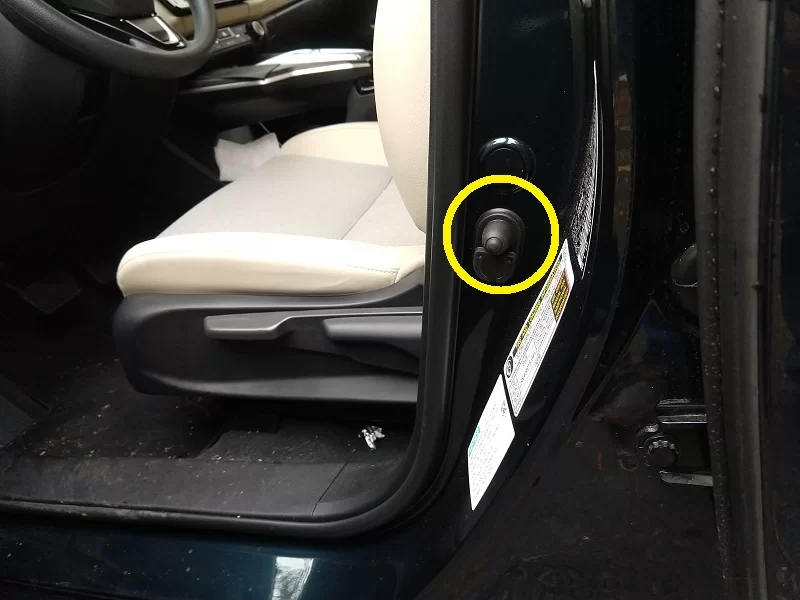

Which button? There are a lot of buttons.
There's a button on the doorframe that the door presses when closed -- see attached with yellow circle highlighting. Yes, pressing this will override the interlock and allow moving with the door open, as will having the seatbelt fastened. I personally verified both just now :)
Still, be extremely careful -- 3000, 4000, or 5000 pounds can do a lot of damage to a head, limb, or chest...

Another way - as soon as car starts to move, you can open the door and keep moving with open door. However as soon as it comes to complete stop - it will flip to parking right away. (And this is make sense - you do not want it to flip to P while driving if you need for example re-close your door)
Well, duh! I have done that with other cars and it didn't click that was what you meant. Some days the brain just doesn't work as advertised.
If you leave the seatbelt on...the car won't automatically go into park.
I'd be careful with that -- I've opened the door while moving slowly in a clear driveway to test it and it did jerk to a stop (to the point that the car was bouncing back and forth a bit when it stopped) -- it's possible a bit faster would just keep moving (I know it'll just flash a message if you're going at roadway speeds), but I don't really want to test it more because it felt like it could break something if I did it a lot.
