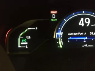

A month or so ago I went for a drive looking for those angry bees. I happened to find them. The bees are real. Their sting can slow you down. Personally, I wouldn't worry about them.
I performed this test on I-70 in Colorado, going through Eisenhower tunnel from the east and west. If you’re unfamiliar with the stretch of road, coming from the east is an exceptionally long climb. Coming from the west is a very steep climb before the tunnel of 2000’ over 9 miles of road.
I started from the East and allowed to car charge to get below 60% so I could run HV charge mode. Car ran like a champ with no power issues. Before the top I killed the ice in order to drain the battery for the next step.
After crossing the continental divide through the tunnel, and regening quite a bit of battery on the way down I take a pit stop in Dillon. I then head back up the hill to hit the very steep part on battery only. I don't recall how much charge, because like an idiot, I'm writing this a month or so later.
So battery runs out of course. Engine kicks on automatically. I turn on HV Charge simply to make sure it was pumping out as much juice as possible. Ends up not mattering because the car takes over anyway.
Battery bar drops to one.
Battery bar drops to none.
Engine revs more and more.
Car slows from approximately 55 or 60 mph down to approximately 40 mph in a relatively short span. This is noticeable deceleration.
I make it to the tunnel, car slowly recovers. I don't think it recovered a bar by the time I left the tunnel, and I think it kept running at a relatively good RPM going down hill for a bit.
I drive another 80 miles home without a hitch.
Theories:
  • The car goes into battery protection mode, prioritizing juice to that that end at a higher ratio than to propulsion.
  • Small engine in a large car attempting to protect battery and forward momentum is going to struggle
  • People have not driven, or have forgotten, what it is like to drive an "under powered" car. Think 1980s econobox. All those were crawling at 45mph, 3rd gear, pedal to the metal. Momentum was the name of the game. It's the way it was.
  • Thoughtless driving may result in sub-standard performance. I in no way mean this as a disrespectful comment, as your bees could have come from another hive (i.e. entirely different and seemingly benign scenario). But not all vehicles can one simply get it, point the front end to the destination, and push the go pedal. Some need a bit of planning and forethought. This car blurs that line.
