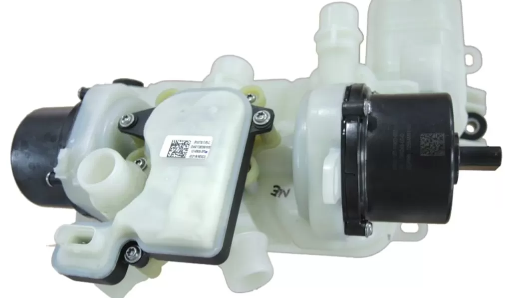

Actually Tesla uses waste heat from the electric motor(s) to warm the battery. In contrast, "self-heating" violates the laws of thermal dynamics. The heating comes with using energy that otherwise would be used to power the car. Inefficiencies in the power electronics and motors leads to heat that is used to warm the batteries.
Sandy Munro discussed this with the Tesla Super Bottle:
There is an excellent article about this existing, two year old, efficiency system:
https://www.teslarati.com/tesla-model-3-superbottle-disruption-video/
You might read: https://en.wikipedia.org/wiki/Conservation_of_energy. There is no 'free energy' but you can get useful work before the energy reaches waste heat levels.
