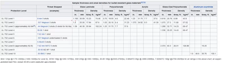

The chart below shows the thickness and strength of the different glasses. Now why would most people need a glass that can resist 7.62 mm NATO 5 shots. The lower cost versions can resist at 9 mm 3 shots and I guess that should be sufficient for most ordinary mortals.
Tesla is going to sell it at $39,000. He already has stainless steel 30x plates. Realistically, I do not think that he will spend or the car needs a Aluminum Oxynitirde window what has a higher density hence higher weight and also far higher cost. Is the objective to provide protection against odd shot or to foil full fledged attack. At this price point, I doubt if he going to for something very expensive.
UL has different codes, I would surprised if Elon wants to UL 762 level 8 or 9, when UL 762 level 1 is better than current cars. Here is a pdf for the UL testing conditions https://web.archive.org/web/20110626221047/http://www.armorcore.com/docs/UL_752_Specification.pdf
https://en.wikipedia.org/wiki/Bulletproof_glass
Bulletproof glass (ballistic glass, transparent armor, and bullet-resistant glass) is a strong and optically transparent material that is particularly resistant to penetration by projectiles. Like any other material, it is not completely impenetrable. It is usually made from a combination of two or more types of glass, one hard and one soft[citation needed]. The softer layer makes the glass more elastic, so it can flex instead of shatter. The index of refraction for both of the glasses used in the bulletproof layers must be almost the same to keep the glass transparent and allow a clear, undistorted view through the glass. Bulletproof glass varies in thickness from 3⁄4 to 3 1⁄2 inches (19 to 89 mm).[1][2]
