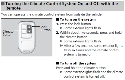

I'm not sure if the remote can start the climate control system if it's inside the car, but here's how page 199 in the Owners Manual describes how the remote can control the climate control system:

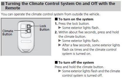

Yes you can start precondition with FOB when you are in the car.... Just remember to unlock to disarm the alarm before you get out....
I do this quite a bit and it works great. Just don't forget you'll trigger the alarm if you unlock from the inside.
Haven't noticed any significant decrease in charge time while doing this. Just wish BT didn't engage when precondition is running.

If you start the climate control from outside or inside the vehicle it will shut off if you open the driver's door, but You can open the passenger door and it will stay on. So sometimes I just sit on the passenger side.
Wow, awesome. Never thought about trying the passenger side
