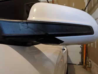

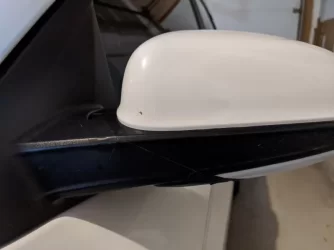

I've been putting little strips of electrical tape along the gaps to try and narrow it down. I had some along the top, but that made little difference, so I removed it. This is what I have left, so still some narrowing down to do, although the problem seems to be either from the front or slightly below. If/when I figure it out more precisely, I'll look into a more aesthetically pleasing solution. And, I see from these photos my car needs a wash!

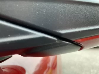

Don’t know if you can see from the photo but I have two thin strips of rubber. One right under the mirror and the other closer to the car. I had to make sure that they do not impede the pins that hold the mirror in place. They are not fixed so when they degrade they could be replaced and the move minimally when the mirror is opened or closed.
