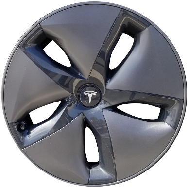

Not that this is a cost effective solution, but Tesla Model 3 wheels and tires perfectly fit the Clarity.
The base Model 3 18" wheels are slightly wider than the Clarity 8" wide wheels
  • 18x8.5 with +40 offset.
  • The tires are the exact right size 235/45R18
  • The 64.1mm center bore is identical to Honda so hubcentric spacer adapters are not required

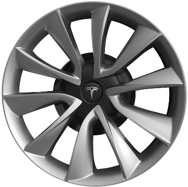

The upgraded 19" wheels will also fit well.
  • 19x8.5 with +40 offset.
  • The tires are the recommended size 235/40R19
