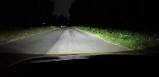

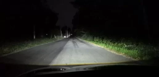

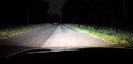

Here are my photos of regular beams and the fogs added, then high beam.
