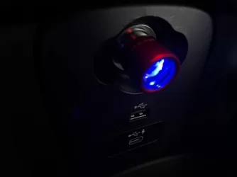

I have this light attached to the front socket and can confirm that the front sockets are turned off when you leave and lock the car bec the light goes out after around 5min and turns back on when you open the car door.IMG_5697.webp
