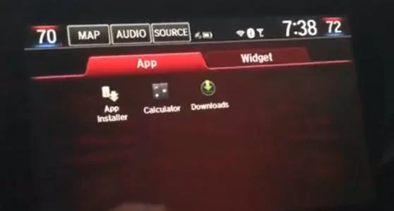

You are making an assumption that everyone has the browser icon, they don't. My understanding is that only hacked systems display the browser icon all the time, everyone else has to go through several screen presses, secret handshakes and tapping their ruby red slippers every time they want to use it. Unless some cars like yours for some reason came with the app screen unrestricted.
