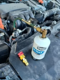

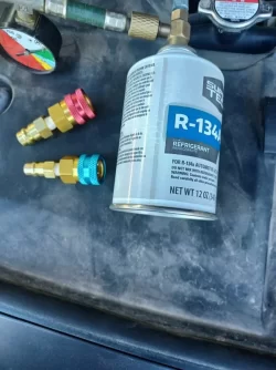

From some research on the web and a local mechanic i decided to put regular r134a into my emty system. I was very careful not to overcharge ( just added the ammount on the sticker on the hood) . The main benefit is that the r134a runs a lower pressure on both the high side and suction side. therefore not as prone to leaking, and is much cheaper than the r1234yf. Ac is working great for about 2 months now. Im not an expert but do have some experience and was advised that the oils in both are the same. The one i used also has stop leak. Do your own research or consult your mechanic. Adapter fittings are available on ebay and Amazon
