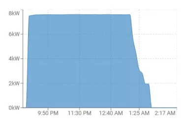

This is the report from my ChargePoint charger from the last time I charged my 2023 Kona to 100%. During the final 35 minutes the charging power ramps down from 7.6 kW to zero, this translates to the last 3.5% of battery capacity during that time. At other times I've never seen a lower rate than the likely max output of the charger, 7.6 kW at home, 6.6 on the one public Level 2 charger that I've used.
I’m pretty sure that’s what I saw 4 years ago when I bought my Kona. It certainly didn’t stay at 7.4.
