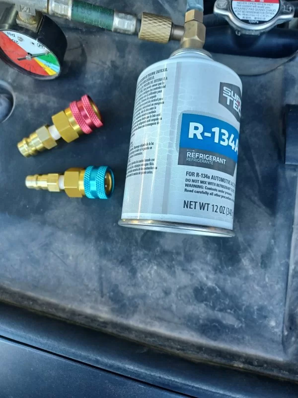

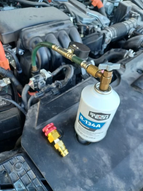

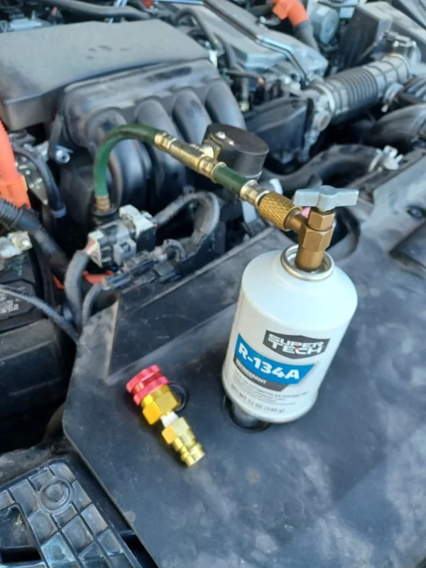

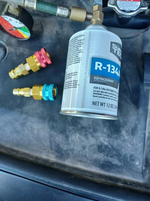

So after some research i decided to go this route. We shall see how it works in time. But blowing really cold. The oils used are the same in both refrigerants. Just used the fitting adapters to connect.
I’m not exactly sure what you’ve done, but I do know that the A/C system on the Clarity uses R-1234YF refrigerant.
Got it. You contaminated a system with a non-compatible refrigerant, tampered with an emission control device and didn’t find or repair the leak.
I did take it back to Honda again before i recharged it and they said the valve was leaking on discharge hose (wich i saw no evidence of) I will tighten up the schrader valves and see how it does. I hope the climate Gods understand....
