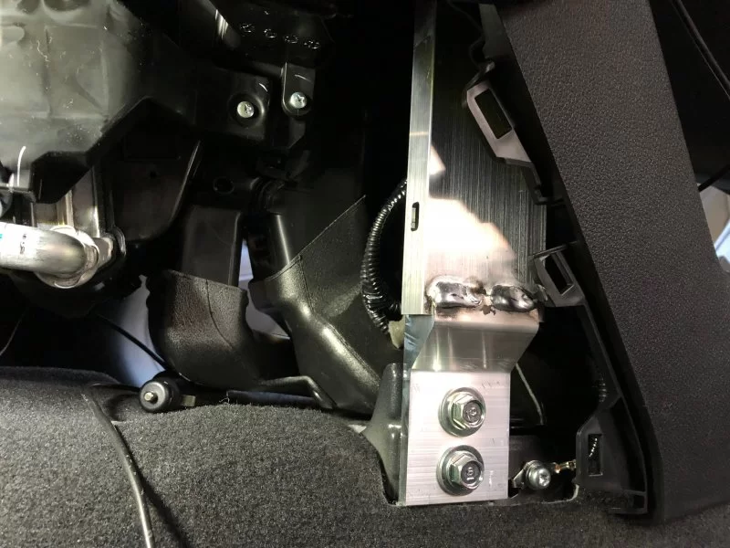

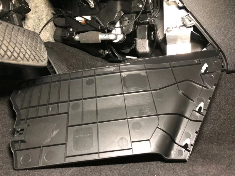

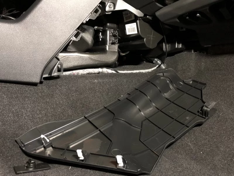

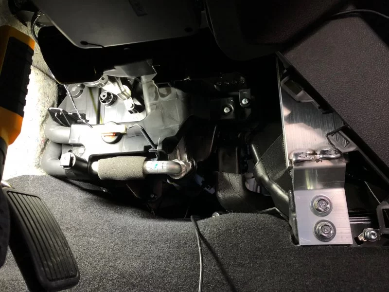

I wanted to hardwire my dashcam so I needed to get access under the dashboard especially under the centre section right under the climate controls to run wires and hide a cigarette lighter socket. I figured out how to do it without breaking anything and thought I'd share how I did it and what it looks like with the covers removed. The 2 removeable covers on the driver & passenger sides just pull off without tools. You just pull directly away from the console on the edge nearest the seats and the 3 clips release, with the panel about an inch away from the console, gently pull the panel towards the seat about another inch to remove it from the connector in the back. Be careful not pull the panel away from the console too much once the clips release or you might bend and break the connector on the rear that is closest to the firewall. The two sides slip into a mating part but beware that the left and right rear connections are different. Now you have full access.
While under the dashboard with the panels removed, I noticed few cool things.

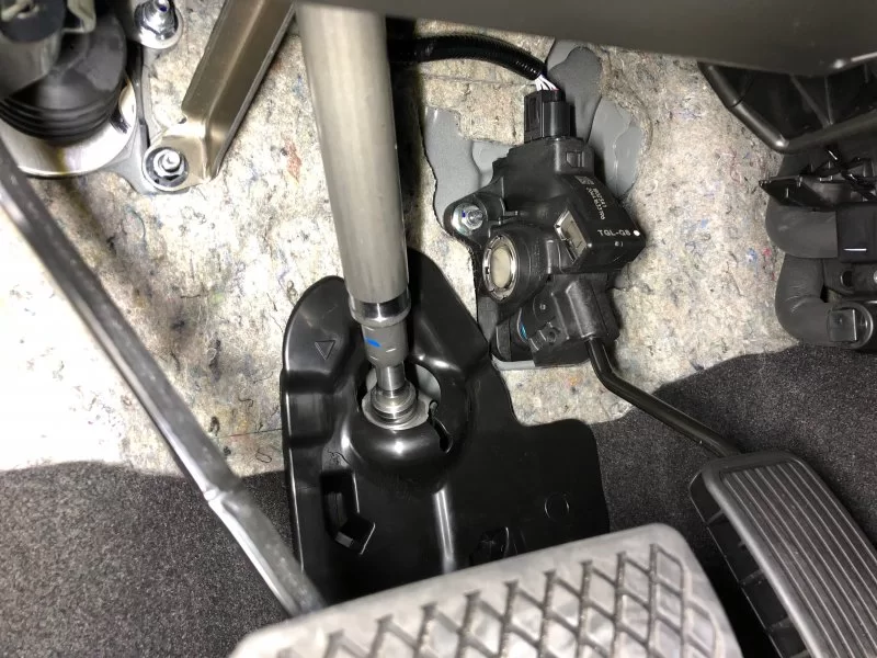

-The GO pedal's mechanism looks very digital, high quality and the pedal itself has a hollow structure to it.
-the dashboard's structure is made of cool looking aluminum - love it!
-the hidden components all have a high quality look & feel with attention to detail. The passenger side rear clip that inserts into a slot has some felt tape wrapped around it I suspect to ensure a squeak & rattle free drive, well done Honda!
View attachment 1865 View attachment 1866 View attachment 1867 View attachment 1868 View attachment 1869

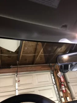

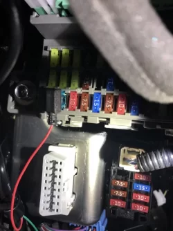

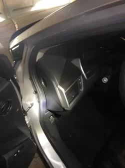

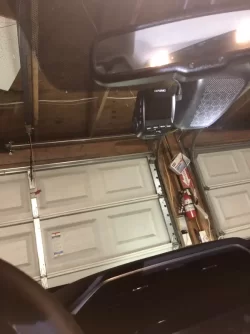

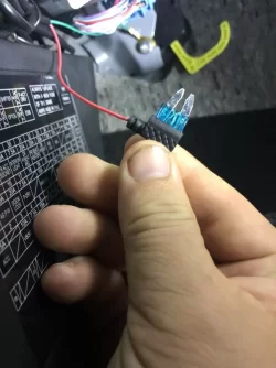

I just got done (literally) installing my dash cam in my 3 day old Clarity and removed absolutely no panels! There are open fuse ports right under the dash above the brake pedal almost, bought a wiring harness that simply plugged into the open fuse port and tucked the wires in the door seal... no need to get to the 12v outlet in the middle console. Hope this helps others wanting to hard wire dash cams.
This is great. One question: Iwrote a lengthy post earlier about how to tap into the ACC circuit in 10 min but of course fuse taps into empty slots are even easier.
I am going to post a fuse map including which fuse positions are “live” only when the car is on and/or in accessory mode.
Which fuse position did you use (C4?). **And is it always live, or only when car is on? **? I’d like to add it to my map before posting.
It’s the “2” slot in the fuse box above the brake pedal (off the left a little) and it is only hot when the car is accessory mode or in run mode (perfect for dash cams and or radar detectors etc)
