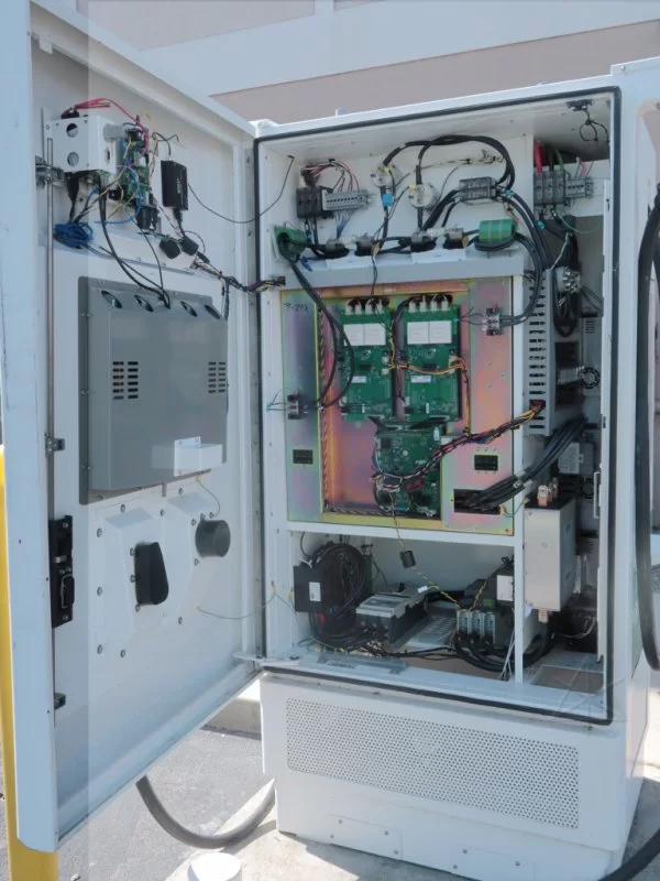

Just because it's fun, here's a shot of how I found one charger at a Duke Energy / Greenlots deployment
near Wildwood FL. Not EA related, but still kind of a fail.
The latch rod actuator was in the "closed" position and locked, so there was no way to simply close and
button up the cabinet to push in the safety sense switch at the top. I was already on the other charger
of the pair, or it might have been tempting to see if I could make this work with a little fiddling ... instead,
I called it in, and relayed the fact that I received from a guy who pulled his Bolt in *just* then, that this door
had been flapping for several days already.

The roll of duct tape I keep in the back would have been handy for such an occasion;)
