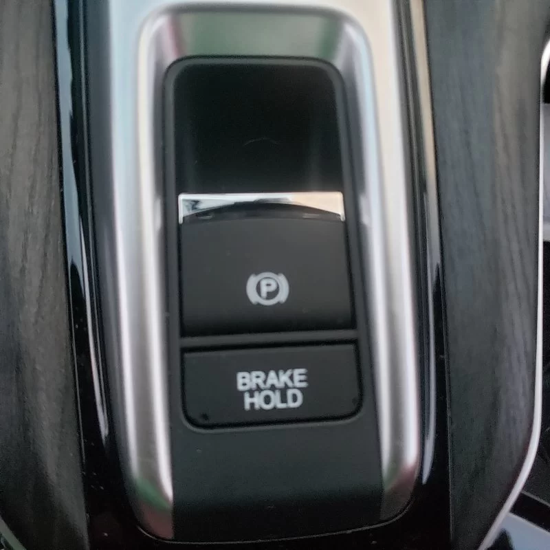

My other issue is, I remember with the Volt, when you push on the brake button, all you have to do to release it is to push on the gas pedal. Most of the time it works, but sometimes I push the gas and I'm still stuck. I don't know if this happens when I turn on brake while I'm in drive, and I open door, get out and come back in again. The screen tells me to press the brake pedal which I do and still nothing, so I just turn the car off and back on and it resets. Am I doing something wrong?

I'm not sure if this is your issue, but in order to release the parking brake automatically, you have to have your seat belt on as well as your foot on the brake.
I'm not sure if this is your issue, but in order to release the parking brake automatically, you have to have your seat belt on as well as your foot on the brake.[/QUOTE]
Oh that's probably what it is, my seat belt is off when I try to move forward. Because I do deliveries so a lot of in n out movement

For the brake hold thing: I've found if you even unbuckle your seatbelt while stopped with the car in drive and brake hold engaged, it will automatically engage the parking brake. It then makes you hold the brake pedal to be able to release the parking brake. I think I read that opening the door will also automatically put the car in park.
Gotcha that makes sense now, I do food delivery and I like to put the brake hold on when I stop, and I can never seem to drive off easily! I know with the volt it worked the opposite, that's what I'm use to.
