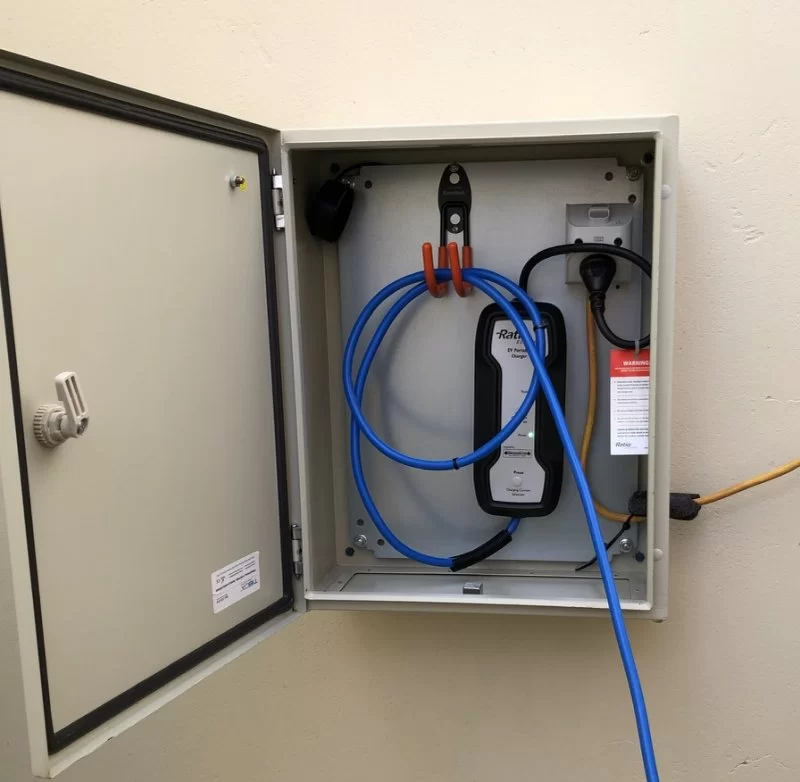

To be clear, when I say "trickle charger" I mean this thing, not one on the 12V battery.
No, it's just a bit of waste foam to keep most water out, not that it matters. Once I decide this is where I want the EVSE located I will have the 10A outlet hardwired to the flat, about 8m of plastic conduit. So far this is the third location in my courtyard I've tried over 10 months as every spot has its pros and cons, some I never had anticipated until tested.
