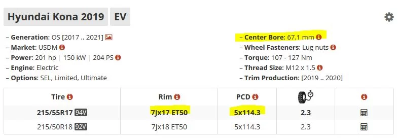

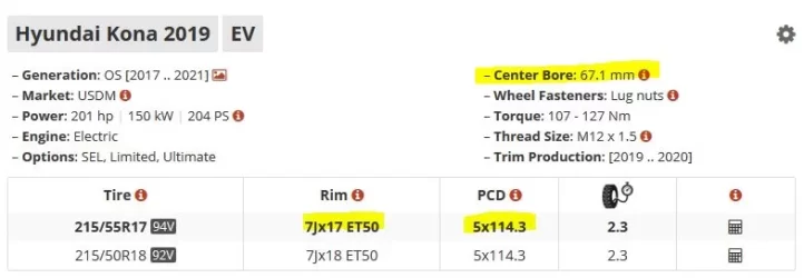

Yellerledbetty Member Oct 12, 2020 #1 Hey All, Has anyone heard of 5-spoke steel rims that fit the Kona? Winters are tough-ish in the BC interior so looking at something with durability and a bit of style. Attachments rims.webp 21.2 KB · Views: 10
