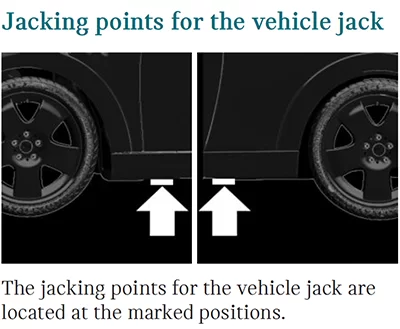

what are the jack points on an SE? TBH I haven’t looked under the car much.
Plastic BMW jack points under the rockers. ICE MINIs also have usable points exposed between the front wheels and between the rear wheels, but they’re not available on the SE.
Jack needs to be fairly low and have a flat saddle (in the absence of BMW-style jack point pucks). A cupped saddle will damage the rocker cladding.
