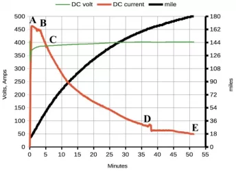

I then recorded the data in this chart:
  • "A" - initial peak voltage, 374 V, and current, 463 A
    • There may be a chemistry transition "notch"
  • "B" - when the charge reached the peak battery voltage-current
    • The subsequent charge voltage and current were driven only by the battery characteristics
  • "C" - the first distinct chemistry "notch"
    • The literature describes how there are internal transient points in voltage-current curve
  • "D" - second distinct chemistry "notch"
  • "E" - ending chemistry curve
Nickel Cobolt Aluminum (NCA) changes are described in two papers:
  • Calendar Aging of NCA Lithium-Ion Batteries Investigated by Differential Voltage Analysis and Coulumb Tracking
  • Aging mechanisms of cylindrical NCA/Si-graphite battery with high specific energy under dynamic driving cycles
My $9k replacement, 2019 Model 3 battery pack replaces the original that began failing in the early Spring at ~150,000 miles. A bad valve in a "5-way" coolant bottle probably "cooked" the battery into early failure. Furthermore, Tesla no longer makes NCA 2170 cells used for Model 3 having moved on to LiFeP battery chemistry. This is one of the last NCA battery pack that will ever be. So I want to understand my battery aging mechanism to maximize the life.
These charge curves led me to understand shorter drive segments between SuperChargers is the fastest way to reach my destinations. I now charge enough to reach the closest SuperCharger along my route with a 40 mile reserve:
  • 1-10 minutes - maximum charge rate for least amount of time per mile of driving.
    • Typically 1-1.5 hours of driving.
  • 11-20 minutes - seeing a fall off in charge rate means a longer percentage of the driving time is spent waiting for a slower battery charge.
    • Usually 1.5 to 2.5 hours of driving.
  • 21-30 minutes - even slower charge rate reduces the block-to-block time as a greater percentage is at a slower charge rate.
    • A maximum of ~3 hours driving.
I'm not sure my data helps your quest but since it involved the latest model SuperCharger with voltage and current metrics, I offer it as a data point.
