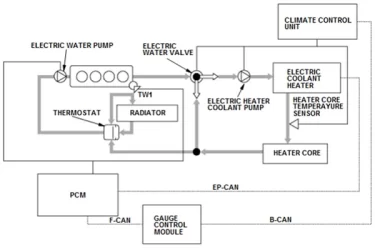

I don't think the gas engine is tied to the heating system at all.
It is actually, if you look in the back of the engine compartment (one day when it is warmer outside!) you will see a tangle of heater hoses. Two of these hoses pass through the firewall into the cabin as usual, one of them being the heater inlet hose. The source of heat for the heater inlet hose comes from both the resistance heater and the engine. There is a hose that carries coolant from the engine into the resistance heater, but it first passes through a valve. Normally this valve is closed so that the only coolant flowing through the inlet hose into the cabin is coming from the resistance heater. But if the valve is open warm coolant from the engine is added to the mix.
I used to assume that anytime the engine was running and warmed up that the resistance heater would shut off and all of the cabin heat would come from the engine. So when I was driving HV I would crank up the heat as much as I wanted, because I figured it was free heat. But as it turns out apparently the valve only opens when it is too cold for the resistance heater to maintain the set temperature in the cabin on its own. But otherwise it continues to use the resistance heater exclusively, even as the engine simultaneously dumps waste heat overboard through the radiator. I have not been able to confirm this but there are indications this is how it works, even though it goes against all common sense. All I can figure is that they felt they could better control cabin heat with just the resistance heater and so it only uses engine heat for the cabin when it is necessary.

Here's a diagram of the Clarity PHEV's heating system showing how both the engine and resistance heater work together to warm the heater core in the cabin:
