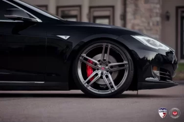

I haven't seen the 22" X wheels on the S, but, here's a pic of the S with 22" Vossen Wheels.
