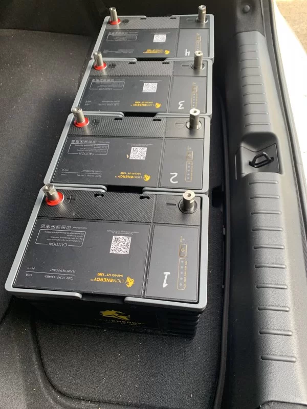

Some want Honda to add more EV range to the Clarity PHEV.
I just put an additional 5kWh’s in the trunk.
They’re actually going in the motorhome. I just drove them down the driveway to the RV barn. They have the same useable capacity as the 6, 6V golf cart batteries that were removed a few days ago. Took out 360lbs of lead and water for 92lbs of lithium.
I got all excited about this and then did enjoy the humor.

I believe it would be fairly complicated. You’d need 7, 48V modules wired in series to create “Battery C”. That would need to be wired in parallel with A and B. Then the cooling loop would need to be added. The onboard charger would charge the bank in about 4 hours at L2 and 18 hours in L1. It would fill half the trunk. The 5376 watts in the photo weigh 92lbs. Two more, which I may add later, would bring the total to 138lbs and provide 8000 watts.
