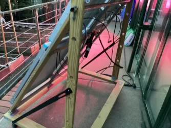

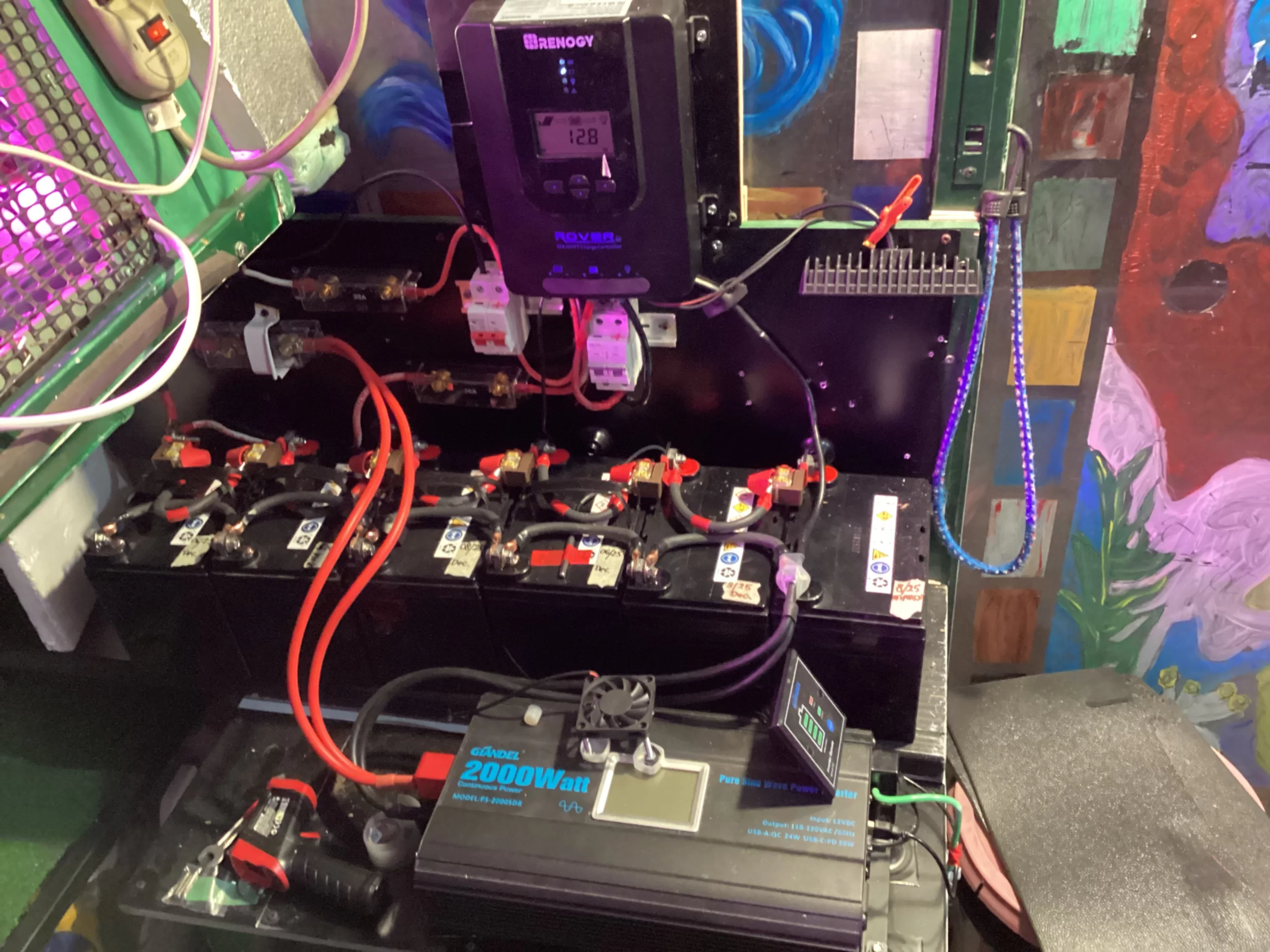

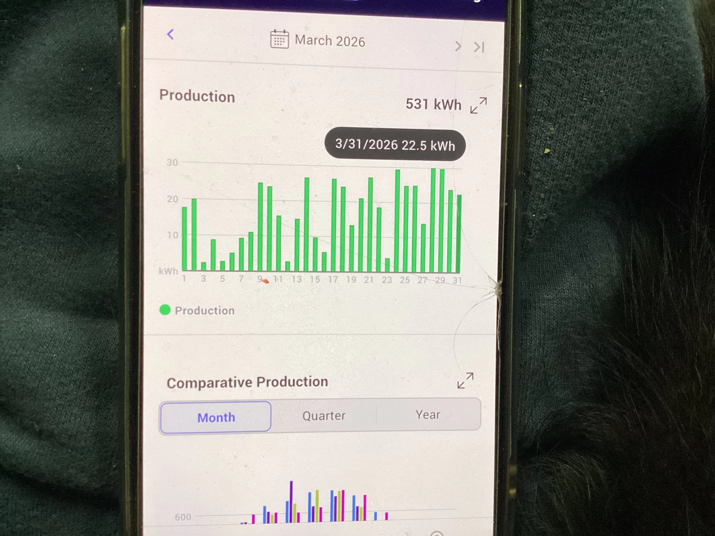

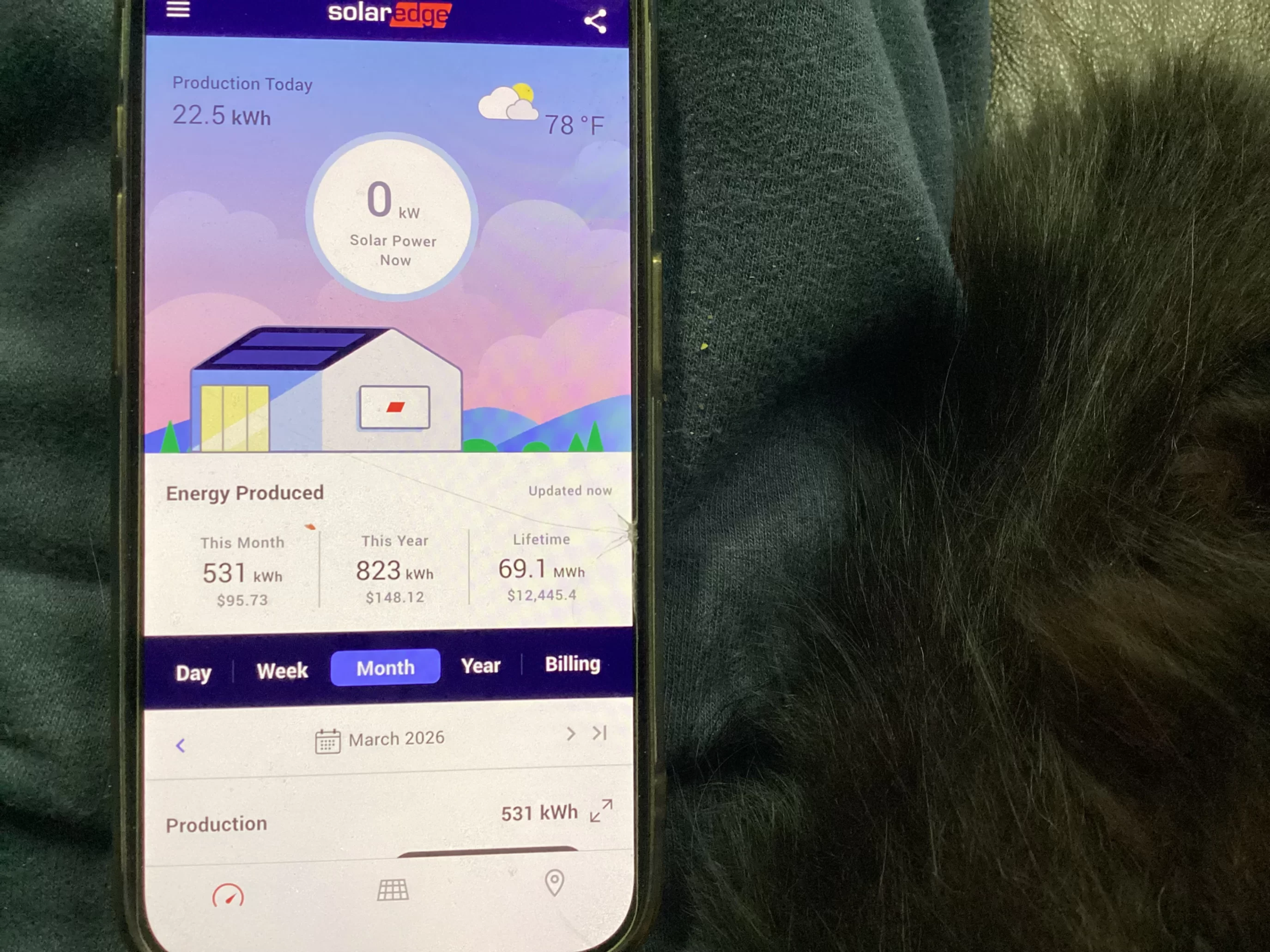

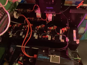

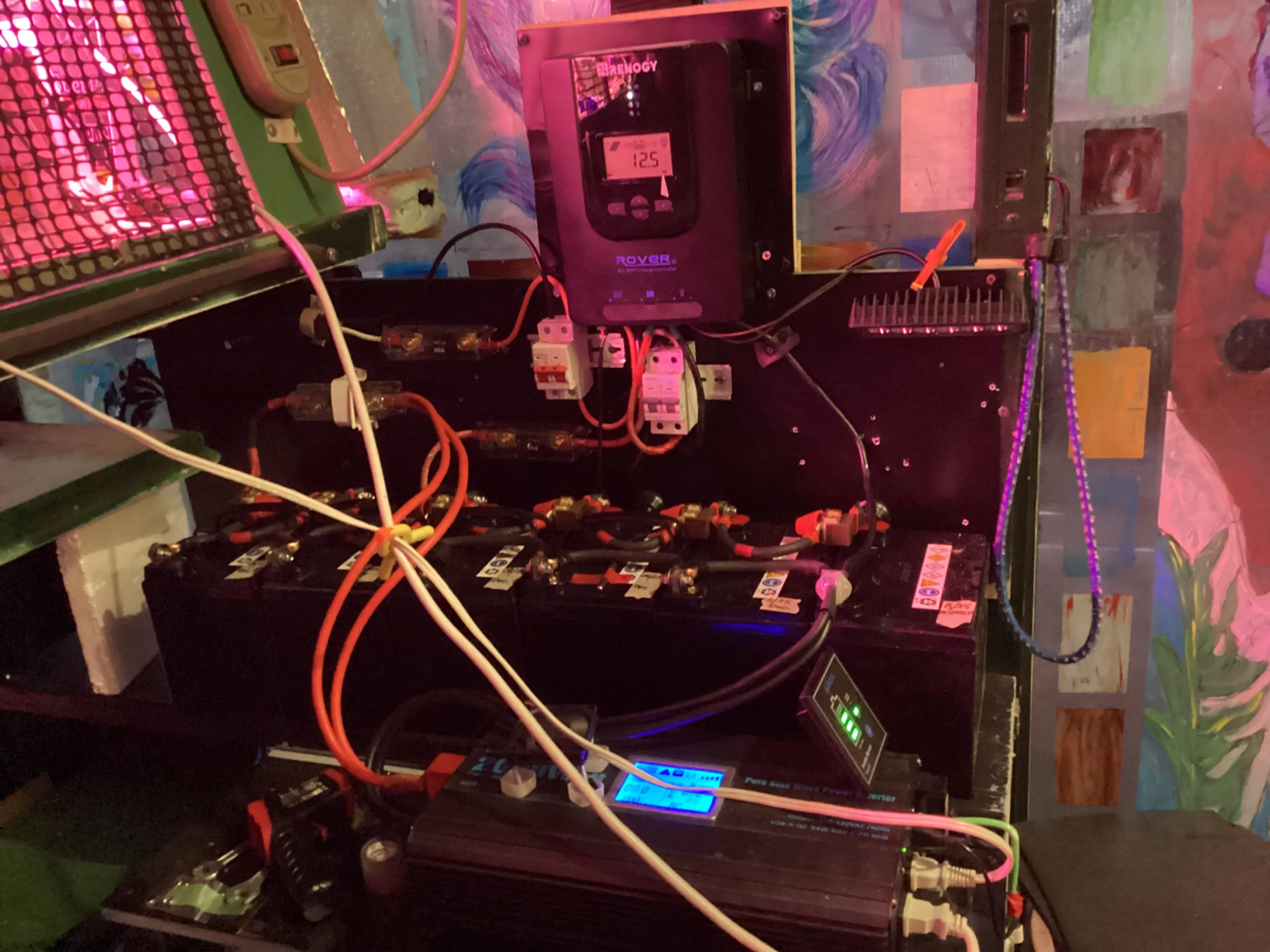

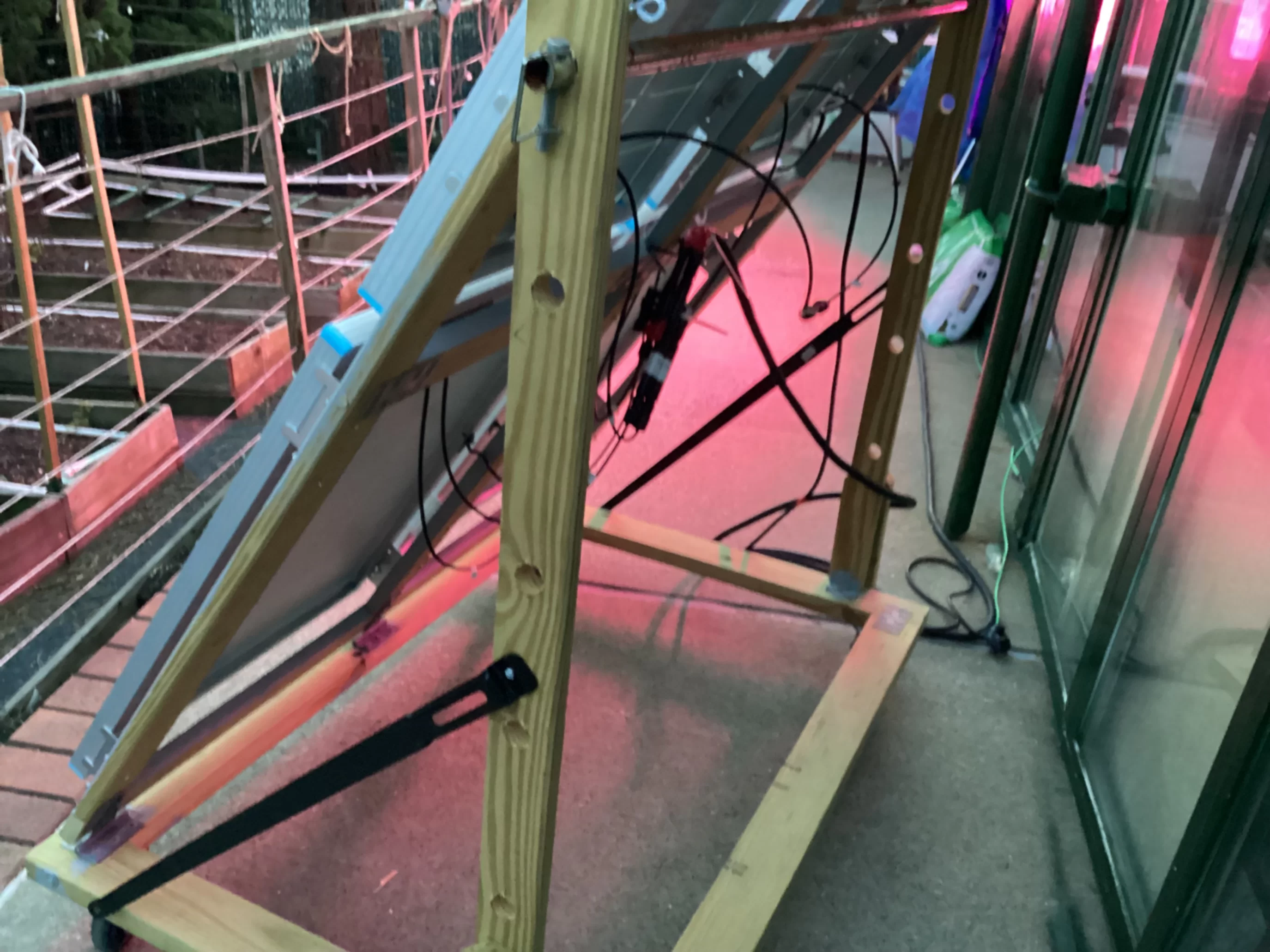

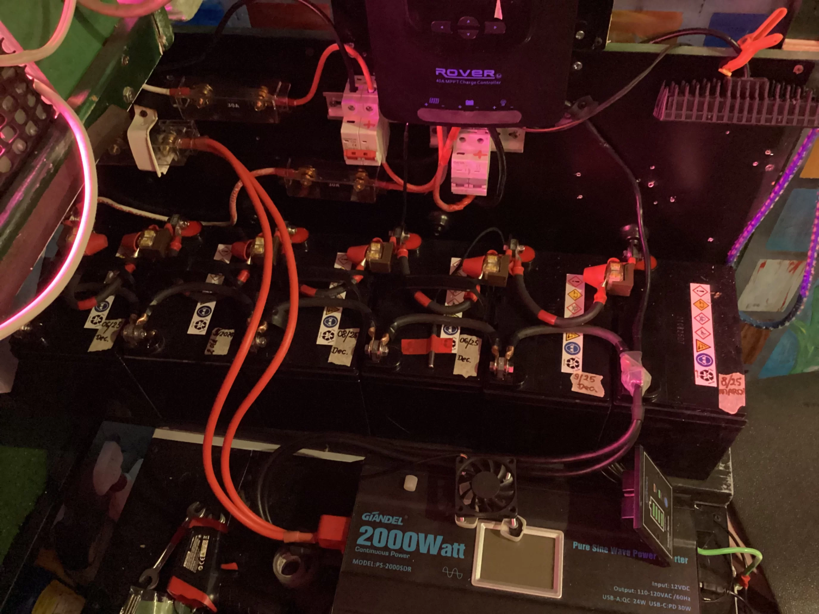

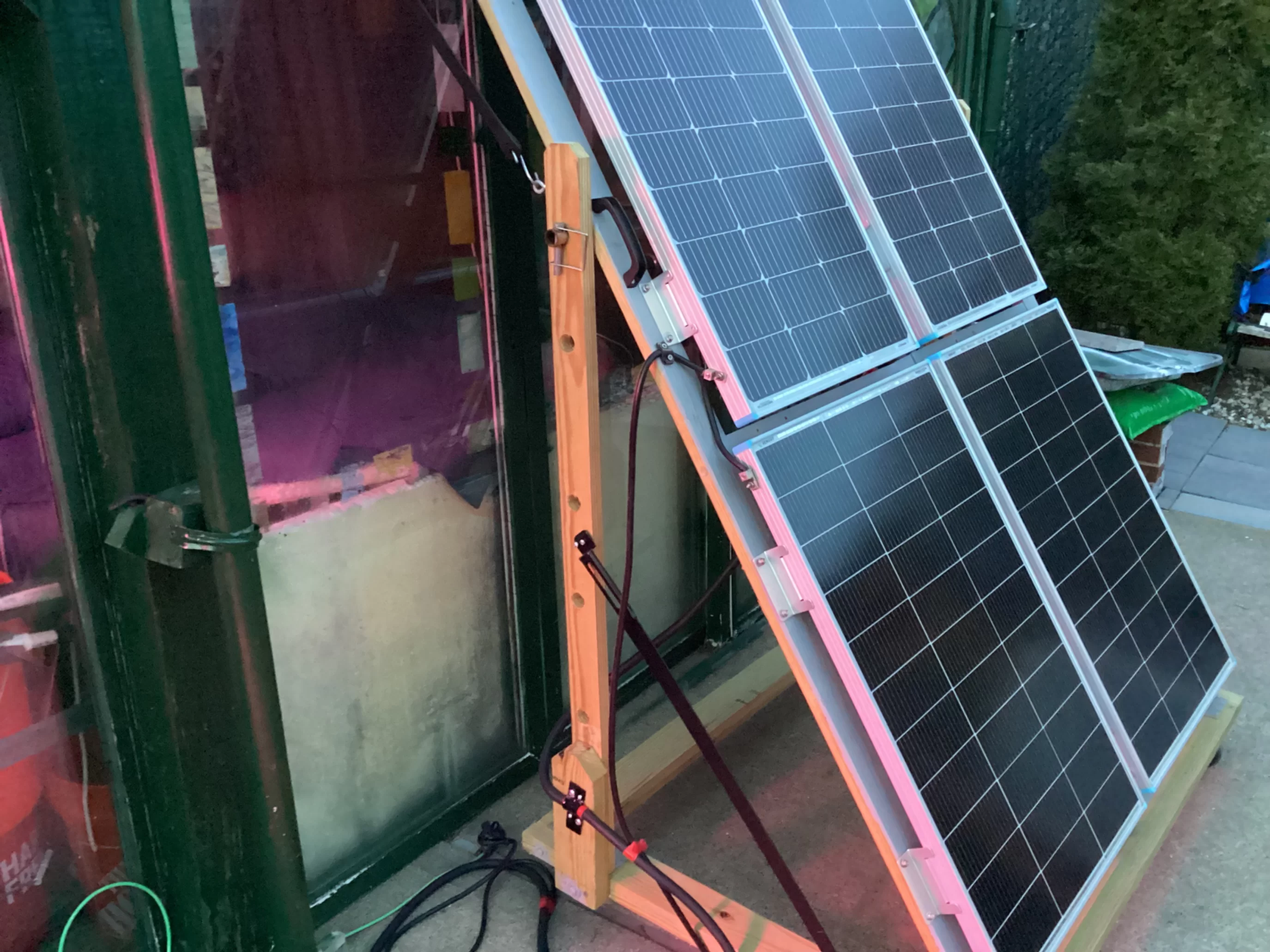

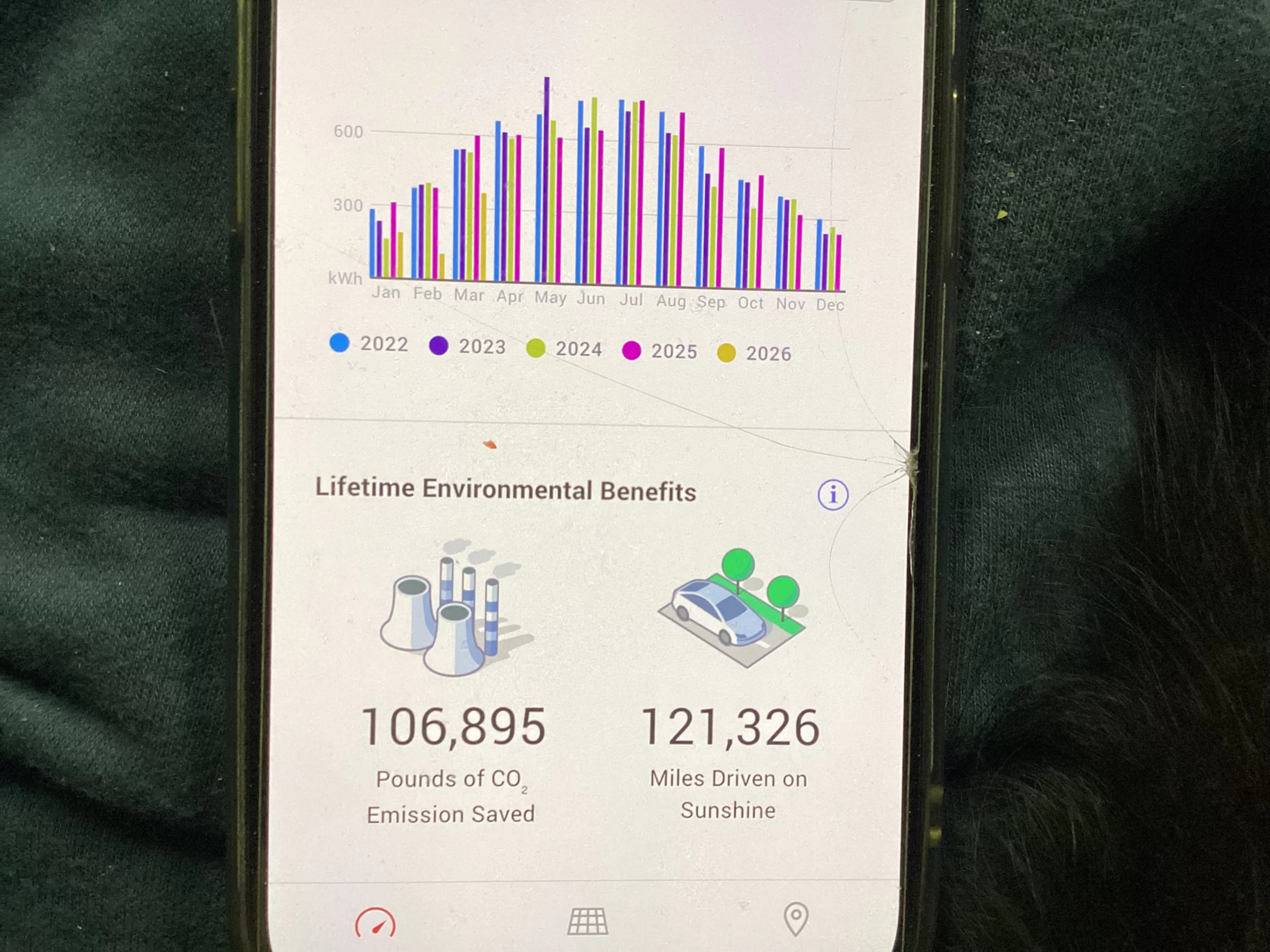

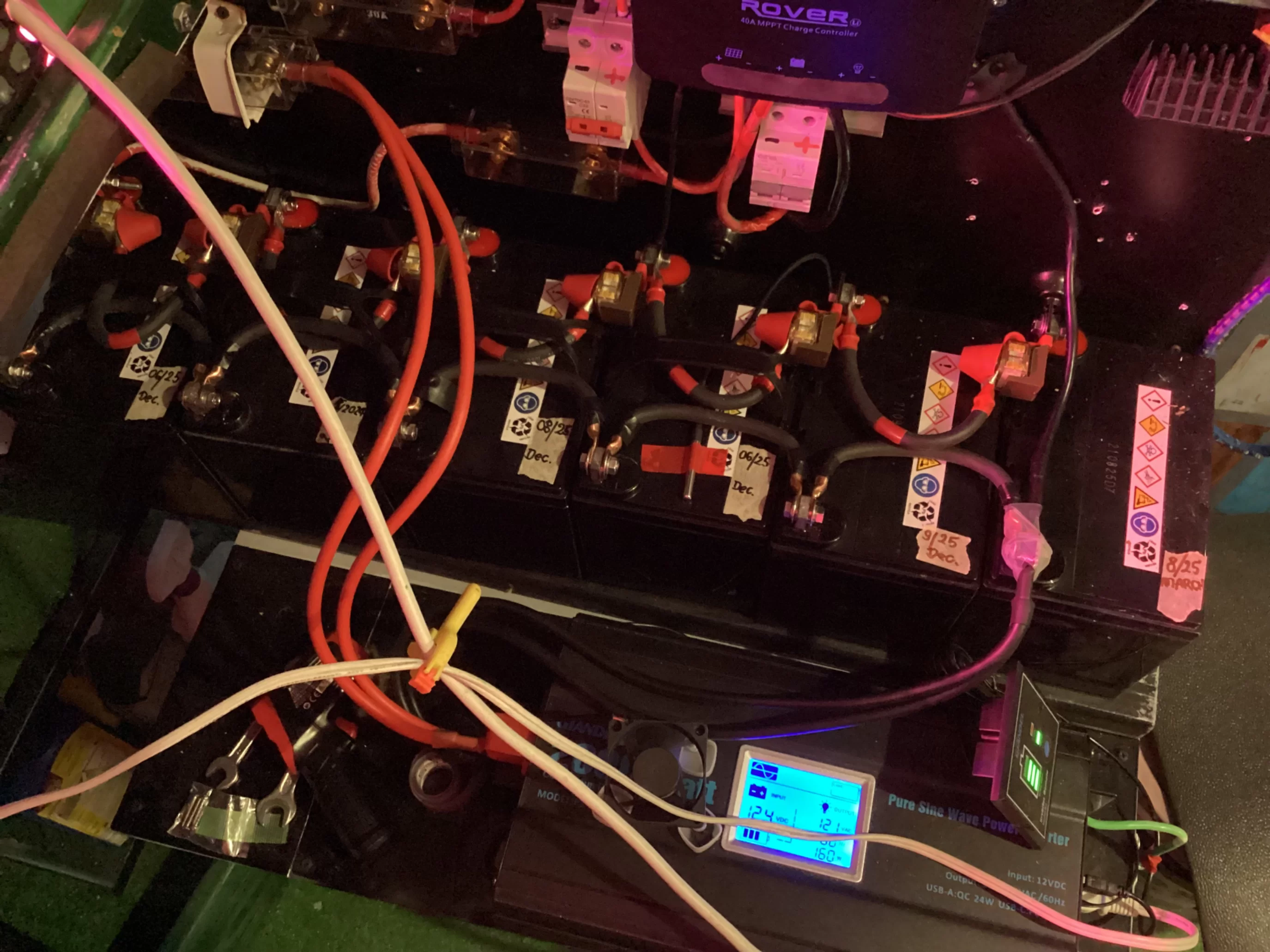

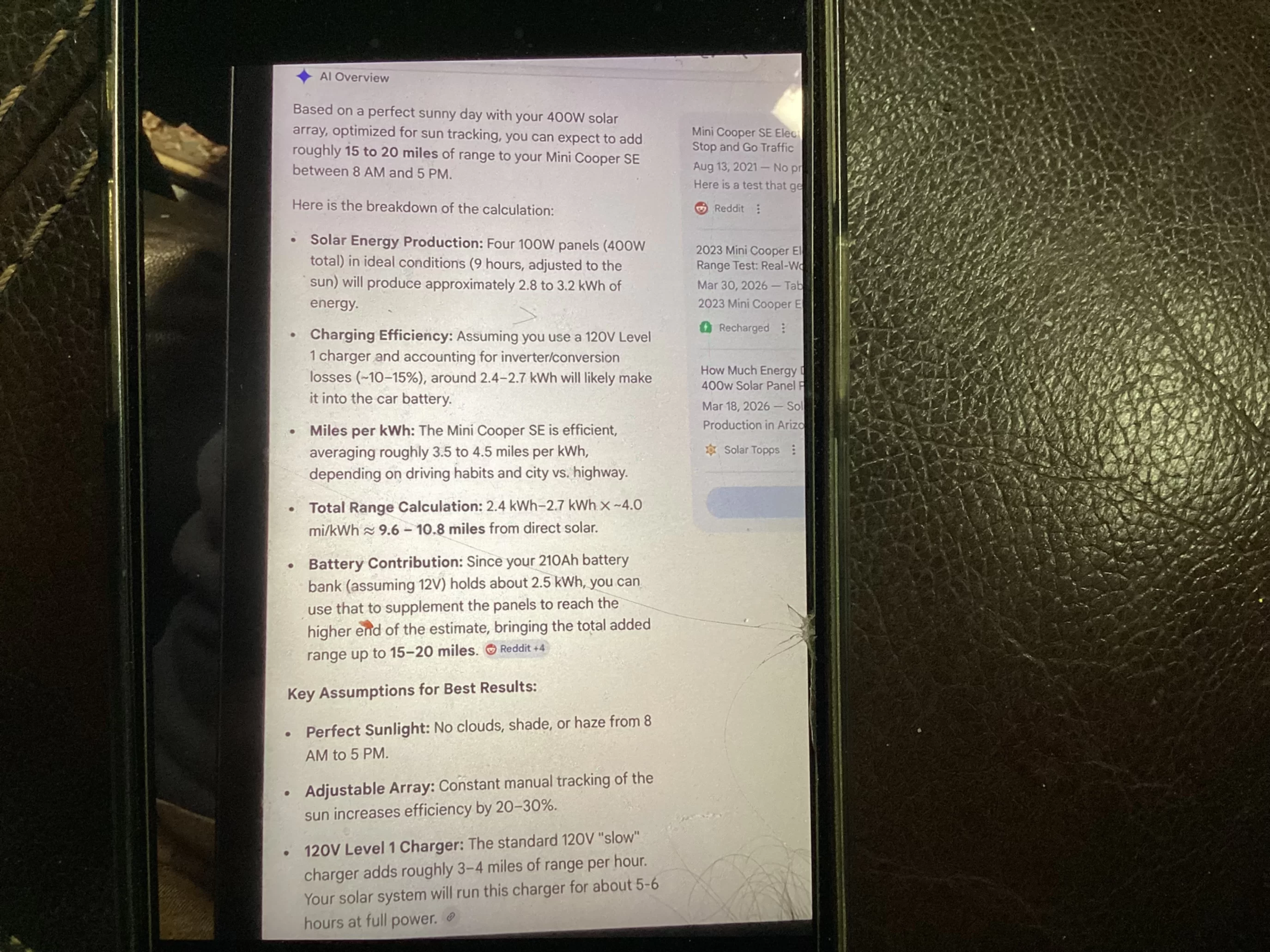

As I charge my SE 4 times a month in my garage on L2 charger about 100 kWh and on public charger 100 kWh traveling to CT but I own solar system on a roof 5.5 kW since 2016 charging I3 for 6 years and SE for 4 years which cost me nothing to drive them .DIY system which I build recently as hobby to run few fans in sun room and growing lights for my seedlings and grow lettuce at winter .I just estimate how my very small solar system could stand to charge SE when disaster hit and is no grid power at all. Obviously I need a sun shine and looks to me I can put about 20 miles in good sun conditions.Some statistic from my roof solar and pictures of DIY system which was build completely in my back yard sun room,array on wheels,adjustable panels from 60’- 45’ 30’ recycle 25’ cable from dead Creeper Creek charger and all crimped 4awg wires ,all 12 v AGM batteries protected with 100 amp.bussmann fuses quite fun to put this together !
