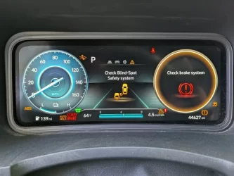

After a somewhat abrupt braking event (45 - 20mph -- someone pulled out in front of me) the dash screen lit up with a bunch of warnings (see photo ).
Car is driving fine, all functions work, but the lights aren't going out.
The 12V battery's at 12.5, I tried unhooking it for 40 minutes. I cleared ECU faults with Torque/OBDII, nothing.
Any thoughts to keep me from having to go to dealer?
Possible my local regular mechanic could reset?
Thanks!
This is not a common complaint when not cause by a low 12V battery so there's no established answer. If it is a brake-related issue I'd step cautiously using a local mechanic as the master cylinder which contains all brake-related functions is a very pricey item. You could check the security of visible connectors under the hood as it could be caused by a more localised loss of power.
Thanks KiwiME.
Local mechanic scanned, ABS pump leak. Must be pretty slow, reservoir is full. Going to dealer.
