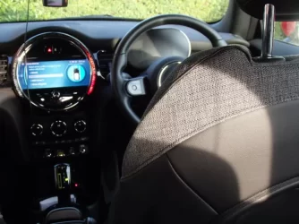

hi all
It is the small oval pod in front of the steering wheel --it goes completely blank see picture attached
I went out for a drive to a local shop around 10 miles and it was perfect no problem at all
but I have notice when it is running it does get quite warm to the touch. Local BMW service place
in the village is offered to put his computer on it to see it it gives any clues but waiting for it to got wrong !!
weather is cooler today
anyway when it next does it I will drop it round to the dealer and see if computer can see any clues
