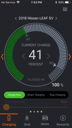

My car is almost exclusively for commuting, and I do not drive fast or aggressively; I park in a garage at home and a parking garage at work; and I generally cycle my charging in a 40 to 90% bandwidth.
What's the procedure for cycling the charge? And what should I charge it to?
I can’t speak to using timers; I use and recommend the emotorwerks juicebox. It’s a tad more expensive, but it makes controlling the charging bandwidth really easy.
I prefer usually living between 40 and 90% due to the Battery University studies. Even so I still only have to charge once every three days
