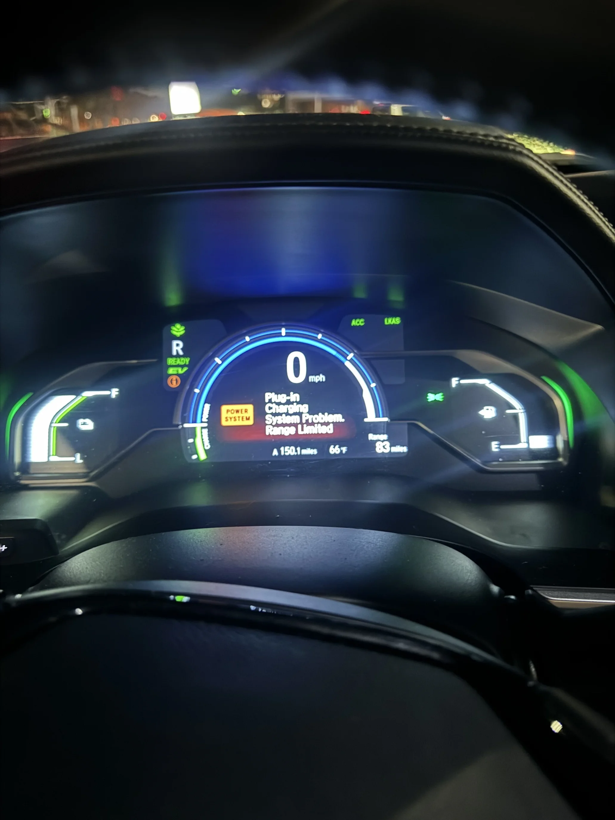

I’m a 20+ year Honda-only driver … multiple Pilots, a CR-V, and a Clarity in the household. I wanted to share my experience in case it helps other Clarity owners understand what the process may look like if a major hybrid system issue occurs outside warranty.
Problem
My 2018 Honda Clarity Plug-In Hybrid recently displayed the “Power System” light. It activated and deactivated for a few weeks. Operation remained normal. Doing some research, I replaced the 12V battery because it could be a potential simple fix.
First Diagnostic

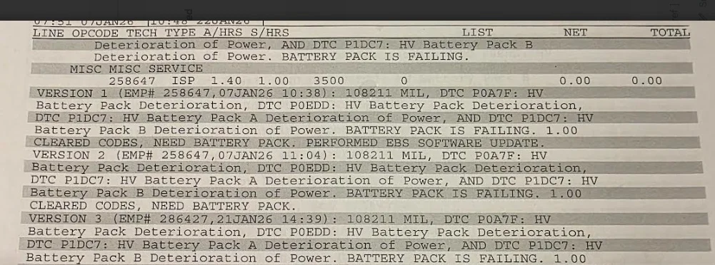

I brought the vehicle to a Honda dealership for a diagnostic and the dealer reported the following codes:
  • P0A7F – Hybrid battery deterioration
  • P1DC7 – Battery pack deterioration

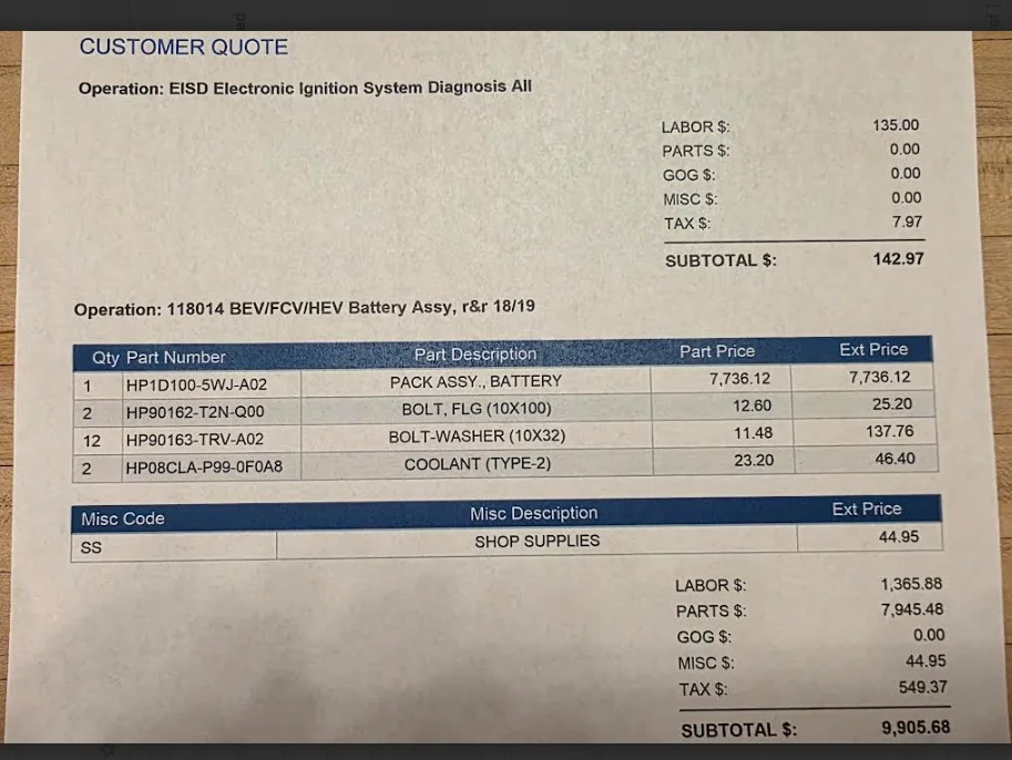

The recommended repair was replacement of the entire HV battery pack:
  • Battery pack: ~$8,700
  • Total repair estimate: ~$10,700
Immediately after the diagnostic Power System light remained and a new “Plug In Charging System Problem. Range Limited” warning appeared upon startup. The vehicle would no longer enter Eco mode, and would no longer initiate charging from the wall.

Second Diagnostic (different Honda dealer)
I brought the vehicle to a second Honda dealership and paid for another diagnostic inspection. The results again pointed toward HV battery deterioration and the recommended repair remained full battery pack replacement.
The dealer recorded additional codes:
  • U0296 – Lost communication with battery charge control module
  • P0AE1 – Pre-charge contactor circuit issue
