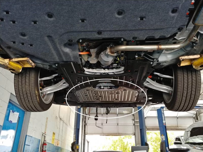

I have never looked but I think there is an aero panel that has to be removed to change the oil. Hard to believe they would leave it off but anything is possible and it would probably make the car sound different.
Yes, there is a large aluminum panel covering the oil change area.
As @Chuck says, it is hard to imagine that the mechanic didn't re-install it, but here's what it looks like (circled):
Having changed my own oil, I can imagine the cover may not be properly installed, and vibrating with the engine.
There are retaining tabs in the middle of each side. For my first oil change, I did not engage those properly, and the thing was loose.
Wow. I wasn’t expecting such good information in a short amount of time. I will check on these and report back. The picture helps.
