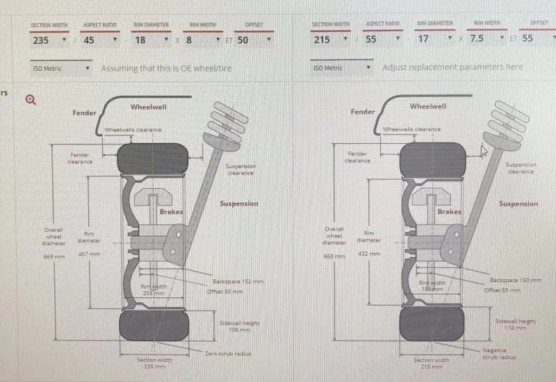

I think I may have misunderstood the relationship between offset and caliper clearance. The smaller offset has greater caliper clearance, however offset differences between stock tires and replacements can effect handling, wheel bearing wear, as well as positioning of the tire in relation to the suspension, frame, fender well, etc. .
I am looking at Konig Control, 7 inch, 5X114.3, 17 inch, 45 mm offset. There seems to be some consensus here that these specs/wheels will work well on the Clarity using 215/55/17 tires.
Getting re-sizing right seems more like an art than a science, and changes in handling characteristics caused by changing tire and wheel size are difficult to predict.
What I am unclear on is how minus and plus sizing, along with offset can impact wheel bearing wear.
