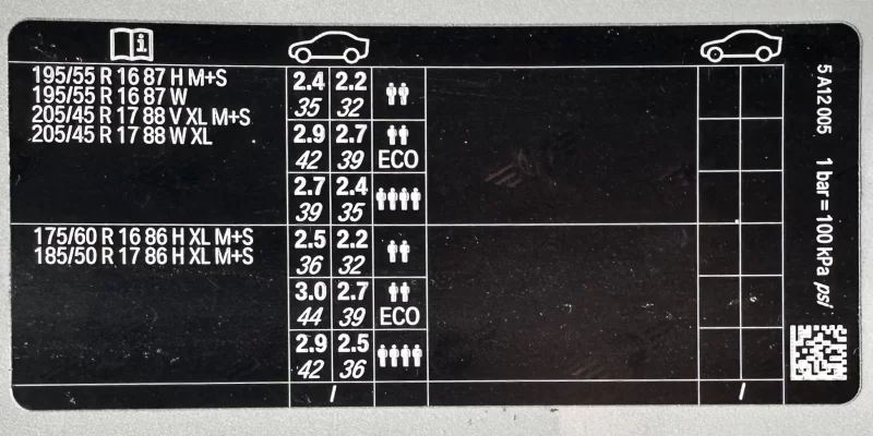

This seems like a good time to repost this graphic, I believe it's the tire pressure plate from the UK F56 Electric, it's certainly more detailed than the US plate. I try to run at the ECO pressure, but I'm having a hard time keeping my pressures correct in the current winter double-digit negative ºF temperatures.
