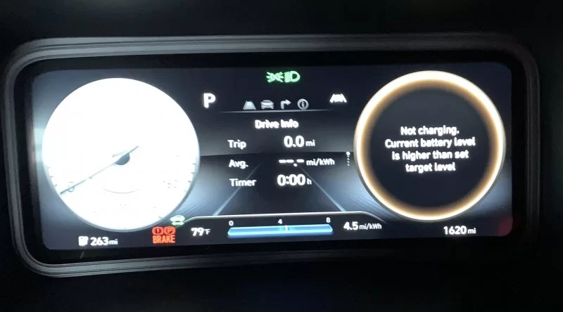

Here’s a pict
- Can’t find an explanation in the 2022 manual anywhere. What’s it mean?
Could it simply mean that your max SoC limit setting has been reached or exceeded? It looks more like info rather than a fault.
"Your car is plugged in and your pre-set charging limit has been reached so I'm not going to put anymore juice into the battery until you burn some of it off."
I would agree, try setting the limit to 90% and shut it off (the EVSE) at 85% and see if that message "disappears" in the morning.
I wouldn't be surprised to see the message stating " Not charging. Current battery level is lower than set target level" :D
