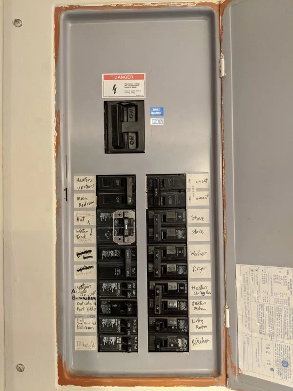

I'm planning on charging my EV using the a Level 1 120V charger. The outlet nearest to the driveway is the maintenance outlet that was installed 5 years ago to meet code with with condenser installation of my mini-split system.
Can I charge off of this outlet? How do I tell if I can or can't?
I attached an image of my breaker box. The breakers marked 'heat pump' were put in with the mini split system.
Thanks!

The two factors to consider are the wire size leading to the maintenance plug and the circuit breaker size. For a 15 amp circuit you need a minimum of 14 gauge wire. Larger wire and circuit sizes are accceptable. The max continuous amps for a circuit breaker is 80% of the circuit breaker rating. So if you have a 15 amp circuit breaker it can handle 12 amps continuous load. You don't say what the amp rating on your level 1 charger is or what EV your charging. My Hyundai Kona level 1 charger is 12 amp max. It works on all 15 amp circuits

As far as the "maintenance receptacle", It is only required when installing HVAC Eq. on rooftops, 26-710 series of rules , must be dedicated, GFCI and 20 A.
So the first thing is to verify that your receptacle is at least dedicated, 15A will work - just not code.
When installing an EV receptacle, it must be dedicated 86-300 (1) unless controlled by an EVEMS which I won't comment on, and have a 20A rating minimum and be GFCI protected when outdoors and within 2.5 M of grade, 86-306 1 and 2.
20 A and GFCI is the way to go.
BTW check breaker 14/16(2P30 -heaters living room) it looks like one side is tripped (turn off then turn on again) unless its an optical illusion.

Thanks for the input. The outlet the outlet is on a dedicated circuits (15 amp) and code indicates 15 or 20 amp is ok. I'm using the stock BMW i3 OUC which is charges up to 12 amps so I believe I should be good as-is.
I checked the breaker too - just an optical illusion it's definitely not tripped.
