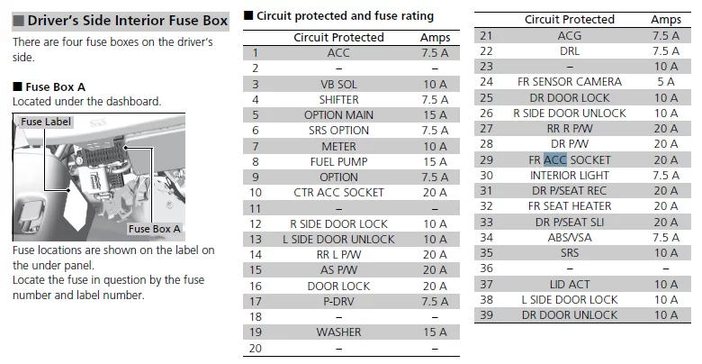

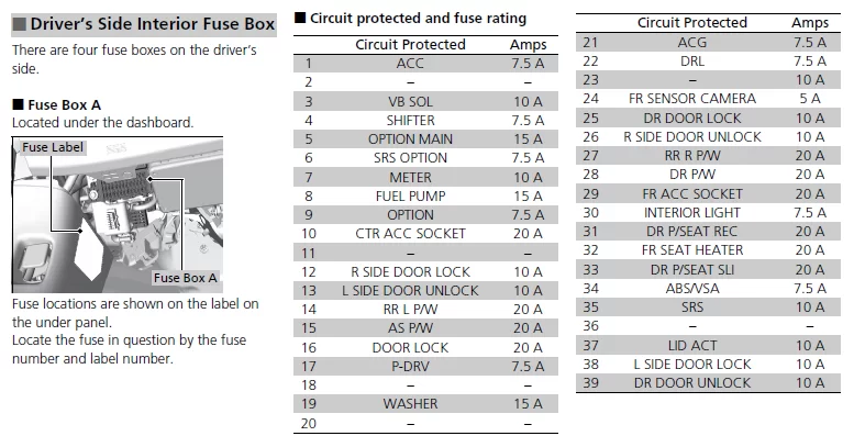

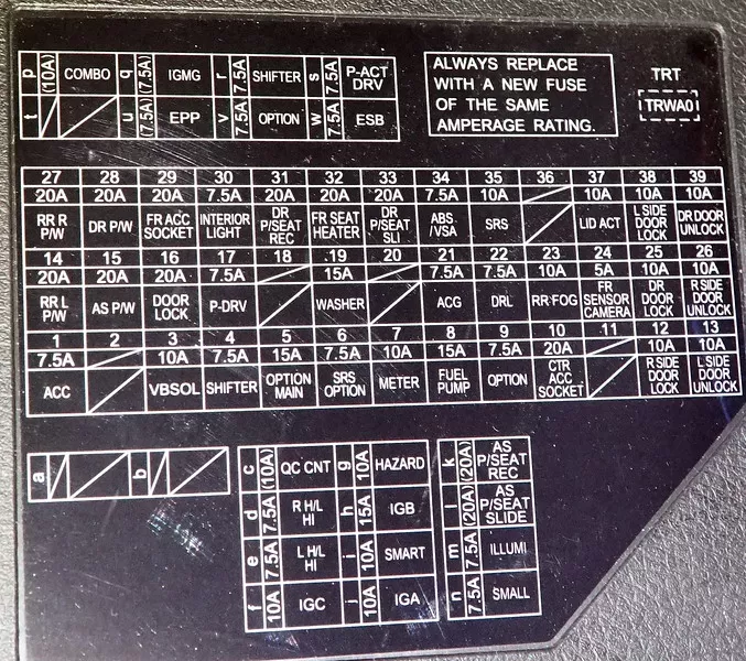

Try first in Fuse Box A which is one of 4 under the driver’s side dashboard.
#10: CTR ACC SOCKET 20A
#29: FR ACC SOCKET 20A
Always replace with same size fuse and never ever with a larger one or you risk a melt down and possible fire.

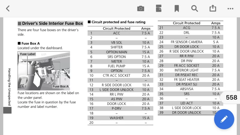

See p 556 in the manual for a picture of it and location of the fuse label to match fuse # with physical location.

Here’s a screen shot of it.
Thanks for the info. I was able to locate and change the fuses which are under the dash. Basically one must lay on the ground (or on a nice mat as I did) with their head and upper body in front of the drivers seat to be able to view the fuse box. Their is "one of each" spare fuses inside the cover of the fuse box that is under the hood. If you need more (as I did) these are ones to order: ATM-LP
