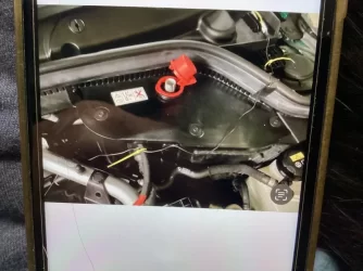

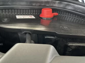

IMG_1186.webp One of the members ask for picture of old battery cover / new first picture/ is more sold .The ugly wiring you see on top of cover ? I’m checking temperature on top of motor. IMG_1147.webpIMG_1154.webp

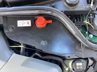

Other forum members have said it's not easy to see the difference with the replacement battery cover. If nobody else does it first, I'm going photograph the difference between the two covers if I can detect that difference (note to self: bring a ruler).

We had ours changed during our 2nd service check last Sep. I think the slot accommodating the cable have changed, I might be wrong.
Attached is a pic of the after, unfortunately I don’t have a pic of the before.IMG_5283.webp

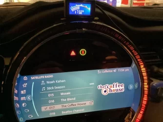

The radio display dimming problem remains after the most recent software update. I pulled into a parking lot just a few minutes ago and the display went completely dark and after a few seconds, brightened back up again. I had to use Bimmercode to fix this once again.
Headunit => Expert Mode => "3005 Display PIP Info" => "DIM_VARIANT" => change the default "NEW" to "OLD" This allows you to adjust the brightness during the day and the scroll wheel by the headlight control controls the brightness at night.
How does this not drive everyone crazy? Such an annoying bug in their software.
My car doesn't have HUD. The center display with the radio is the problem. The outer ring does it too but the easy fix for that is to just turn that off. I never have that on.
BMW owners complain about this too as well as other F56 owners. The little light sensor is in a poor location and with tinted windows, it sets the amount of brightness on the display during the day frequently wrong so it goes dark, bright, dark, bright...
