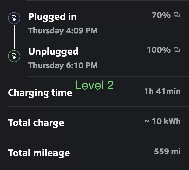

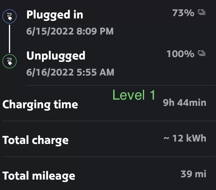

I used a level 1 charger for a few weeks before I installed my level 2. I drive around 50 miles per day. My level 1 charger had a total charge of 12 kWh. The level 2 charger used 10 kWh.
