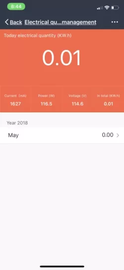

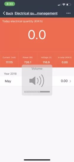

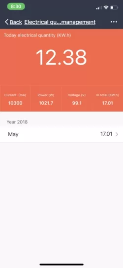

Okay first picture is the start of the car charging. Voltage peaks for the first 10 seconds and then settles at the levels in the second picture for the remainder of the charging session. 3rd picture is the freezer. Amps peak for the first 3 seconds then come way day for remainder of the time running. These measurements were taken while both were plugged in and running. So technically you would be exceeding the rated amps as Mike stated and an electrician would not recommend. If I were in your situation, I would hesitate to charge not knowing the wiring situation. Like I said before, my wiring is 12 gauge which is a step higher than what is needed for a 15 amp. Also before I put the GFC plug back into the wall, I took temperature readings of the plug itself while under load from both the freezer and the car with my laser temperature gun. I also took readings of the temp of the specific wire where it enters the circuit board (even though the wire is insulated I was looking for any fluctuations in temperature). No warm temps and no spikes. So I am comfortable with my setup but you never know about other people’s.
