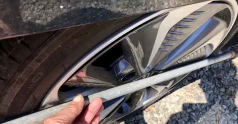

...no longer a rim virgin:
Right front while parallel parking. I can blame a curve in the road where the curb was quite high, but it still seemed awfully easy to do.
I wondered how we managed about 14 years and 205,000+ miles in our Element without similar damage. I just checked, and the Element has about 3/4” of tire protruding beyond the rim:

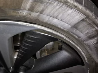

I bought a black wheel from a fuel cell Clarity with curb rash (not as bad as your photo, but significant). I sanded it out starting with rough sandpaper and working up to about 400. Once it was smooth, I painted the whole wheel with Rust-oleum Aluminum paint (white can labeled Metallic Finish and with Bright Coat in yellow circle). The printed number on the bottom of the can says 7715 Aluminum and under that HD 2 22 2. Anyway, I couldn't believe how well this turned out. I put the painted wheel alongside the original stock wheels and I can't tell the difference. Certainly with it separated a few feet, no one could tell. Of course I had no tire on the wheel, so that made it a lot easier to paint.
FWIW Curbed wheels like that are routinely repaired and refinished in the body shop world. They don’t necessarily do it themselves but they farm it out to Keystone/LKQ or other vendors who do it for them. $125 is typical shop cost to make something like that new again, plus labor to dismount/remount/balance the tire. And some wait time if you drive a unicorn like Clarity and they don’t have a wheel exchange program like they do for more common wheels.
Also used car dealers have mobile wheel repairs done routinely on their lot. Chat with a large used car dealer and see who they use for wheel repairs on their lot and get a phone #. One of those guys might come to your home and do the repair while you wait, much like the windshield guys. It takes them 1 to 2 hours and again $125 is a typical cost. They just break the outside tire bead loose, fix it, then reseat the bead. Doesn’t even change tire position so no need to balance and you save dismount remount fees. I’ve had such services do wheels at my home more than once, but I was in the business and had local contacts....

My 10,000 mile tire rotation is about due. I’ll use that opportunity to get the wheel and tire to waist level and work on it a bit. And that paint recommendation will be a great help!
Update;
Just rotated my tires, and spent about 20 minutes working on the road rash with sandpaper:
Looks a lot better. For now, I just waxed the bare aluminum - I’ll get the suggested paint next time out.
